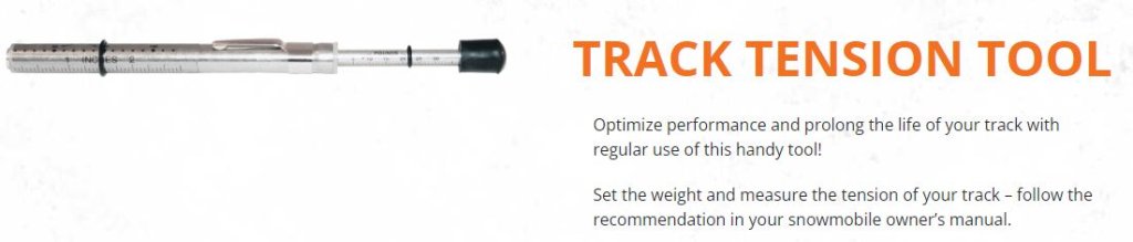

That ISAT guage is pretty slick. I recently picked up Woodys track tension tool but have no qualms with it
