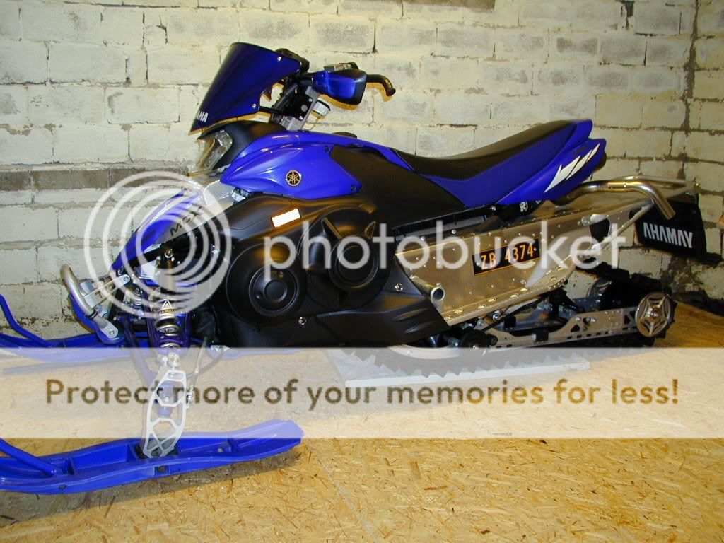

I definetly needed som modification/extension. Could have something to do with my larger rear wheels of course.
Track still touches rear of tunnel in extreme bumps if riding 2up.
This is no go:
Much better here.

Ready to weld modified extended rear bumper grab bar. It was just too short with the 136" track.
