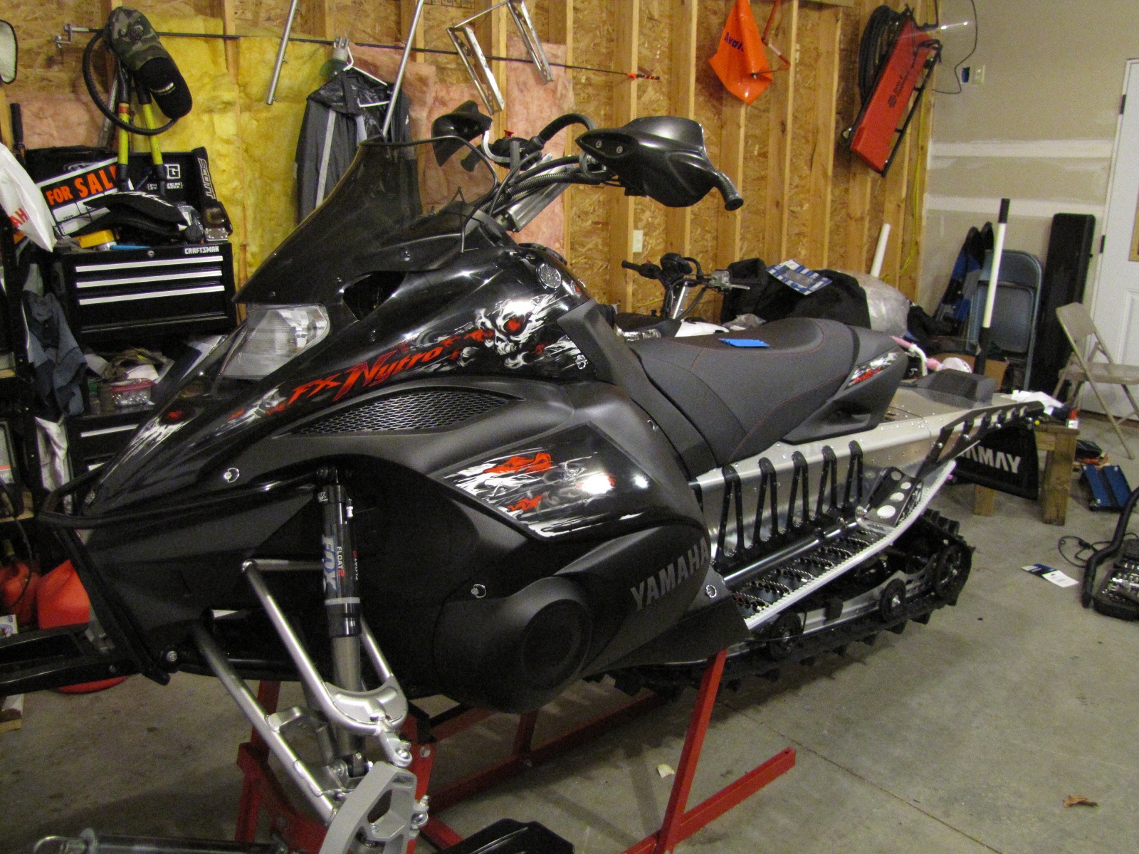

savan2000
are those ones in the pic from yamaha?
How does the color hold up, are they powder coated or anodized?
The ones I have are from yamaha. They are actually the ones for the xtx and shortie. I modified them to fit on my mtx. I'm not sure if they are powder coated or not. I'm put a 1000 miles on my last set and never saw any wear.
