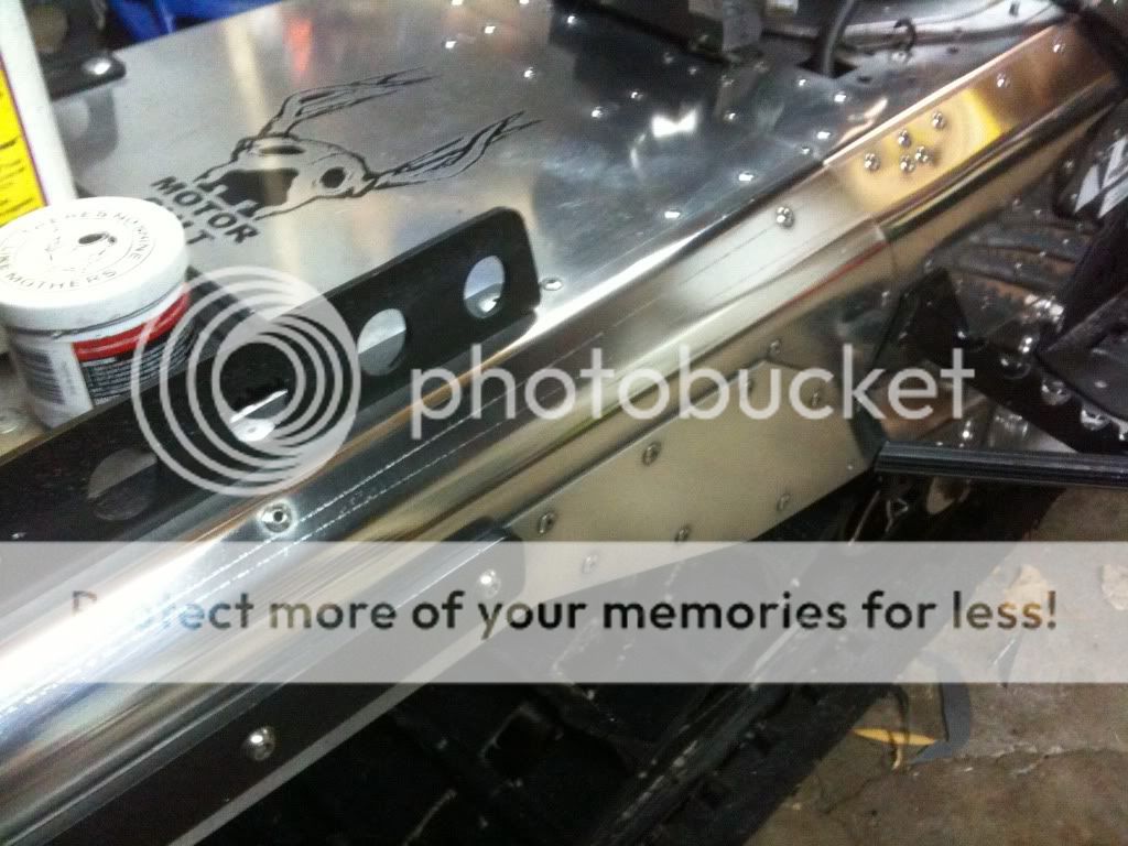

I have sanded it real nice and i keep polishing and i can only get it to look like an out of focus picture its not very clear just kind of fuzzy what am i not douing right?
RIKMAN did you polish your spindles also? Did you take the black reforcements off or polish around them? Either way it looks good.RIKMAN said:This is how she turned out.![]()

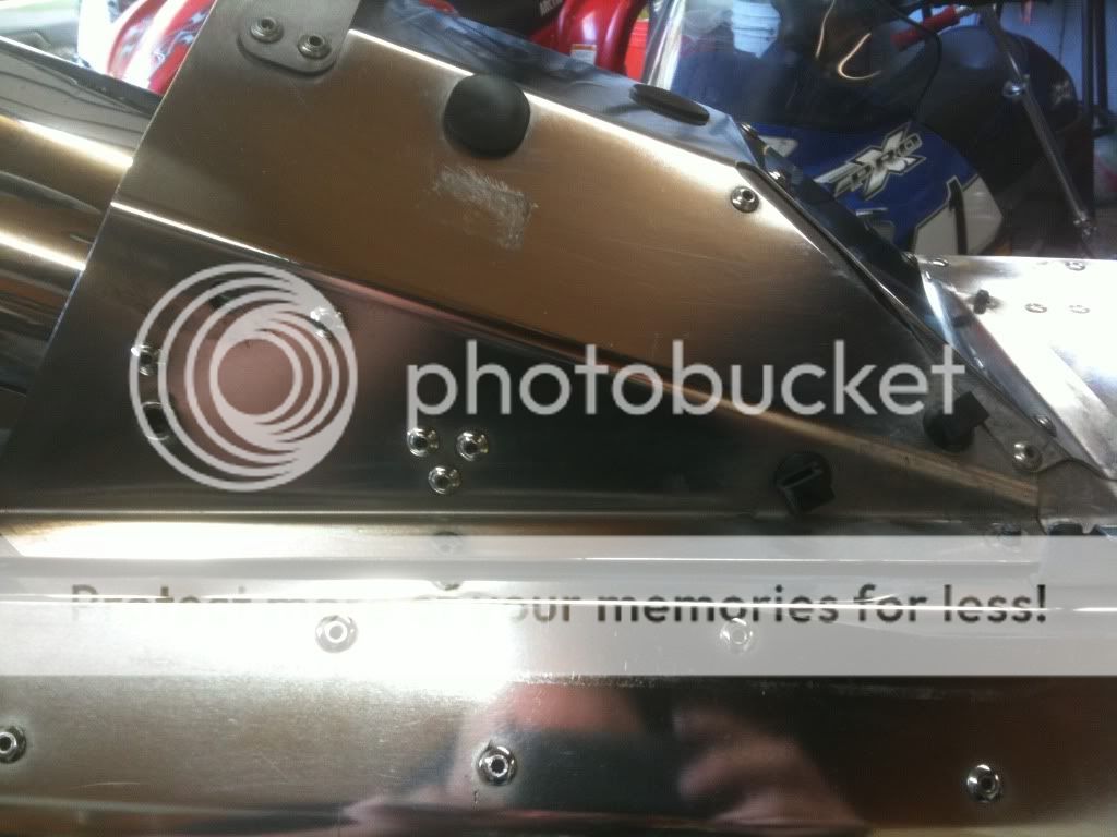

bottlerocket said:RIKMAN did you polish your spindles also? Did you take the black reforcements off or polish around them? Either way it looks good.RIKMAN said:This is how she turned out.![]()
Thanks
Yes i did polish the spindles. One day to strip paint off and sand to 1500 grit and 4 hours of polishing. And the reinforcements was installed after.
Mostly polished everything aluminium on the sled. (spindles,rails,tunel,risers)...
The worst part of it is to keep it shinny

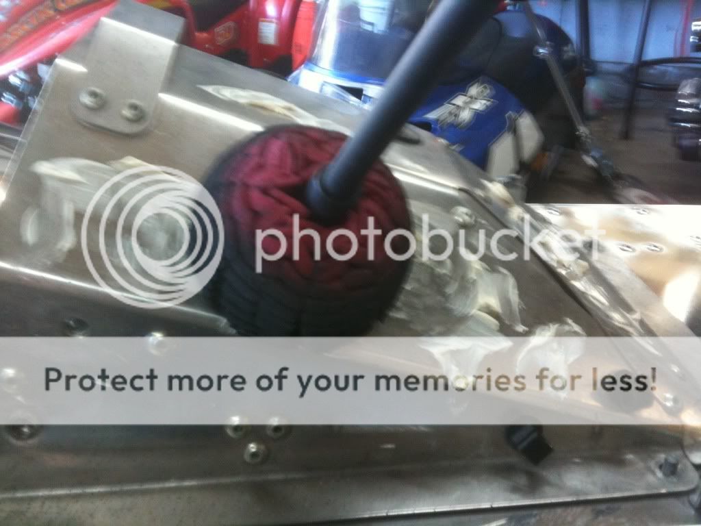

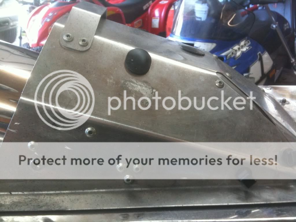

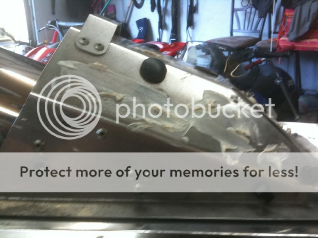

Stoli
I recalled reading this last year and thought I would post what we found that worked well. Mothers makes a "Powerball" and Mothers "Mag and Aluminum Polish". Ball was about $18 and polish was about $4 - also get a bundle of terry cloth towels for 4 or 5 bucks too.
Put some polish on the area to polish, use a drill and the Powerball, when it become a black color, wipe off with towel. You will go through a lot of towels. The more torn down your sled is the easier it was to get around some areas.
