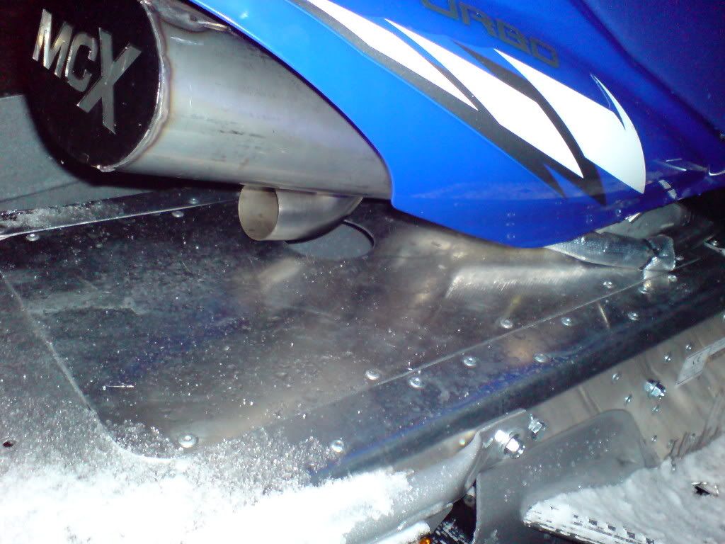

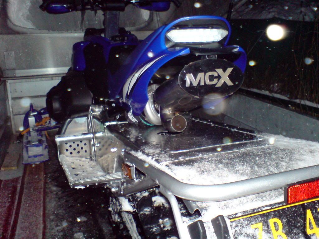

just got the sled back from turbo installation with the "new" exhaust outlet:
136" Freeride track:
