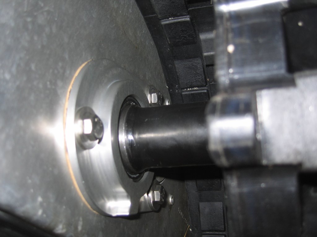

I designed a nice CNC machined T6061 aluminum seal plate made to stop water from getting to the tunnel side of the bearing. Every year, I found my bearing had the grease washed out and was rusting. This may solve that problem. The OEM plate is junk and you can bend it in your bare hands. It is always bent and has a gap between it and the tunnel allowing water in behind it. This plate is solid and I have a gasket between it and the tunnel along with thick stainless washers and stainless bolts.
The kit looks like this.
Once this is installed, you may wonder how do I get it apart to change a bearing or a track. Well you need to make a special tool to pull the caliper. Here goes.

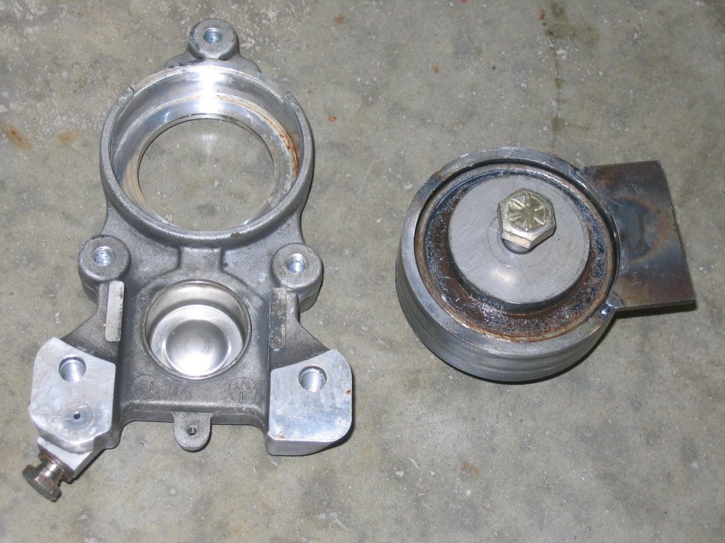

This part is a machined puller button to place in the ends of the hollow shaft to pull against. The pilot shoulder stops it from slipping down when you install the puller.
The actual puller looks like this.
When installed, it looks like this.
Turn the bolt and the caliper comes right off.

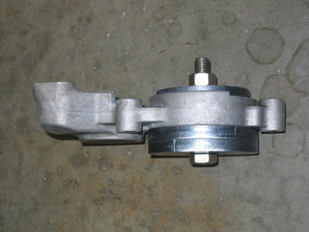

If you need to change the bearing in the brake caliper, I have a nice tool for that too. This is stack of laser cut disks and a laser cut tube thicker than the width of the bearing. Depending on how it is assembled, it will effortlessly remove or install the bearing. Here goes.
Assembled like this, the bolt draws the bearing into the tube as the nut is turned. When it is fully removed, the housing falls off the tool. The small disk pulls on the inner race.
The tube pushes on the housing and pulls the bearing into the tube.
To install the bearing the tool is assembled differently to push the bearing in by the outer race.
