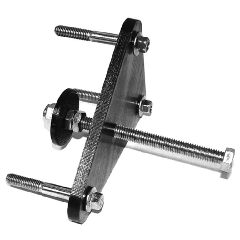

For those who may not have seen it, Travis H at BOP created a template for a puller for the caliper housing (with bearing in it) for use when one presses the bearing on. No need for a center bolt because the plate just pushes on the end of the track shaft. If you print this template at 100% scale, you can just lay it on your chosen piece of 1/4 thick steel and make one easily. PDF for template is attached.
For some reason, Arctic Cat also makes one. Since their design doesn't use a bearing that's pressed on, I'm not sure why they have this tool. Cat p/n is 0744-067. Country Cat now shows this tool as no longer available. Since plate pushes on end of track shaft, the center threaded bolt isn't necessary.
For those who may not want to have to remove the belly pan plastics to use press tool BP shows, I made my press tool threaded rod in 3 pieces so I can install one piece at a time (without having to remove any plastics) and they thread together to create the rod length needed. The hexagonal nuts are threaded all the way through. I welded one end to threaded rod to keep them from turning so I could thread the next piece on. See pic attached.

The long threaded rod is to put the shaft together, not take it apart. I push on a shouldered round plate as well to get the caliper off. This can be done with the chaincase fully assembled to simply service the left bearing.For those who may not have seen it, Travis H at BOP created a template for a puller for the caliper housing (with bearing in it) for use when one presses the bearing on. No need for a center bolt because the plate just pushes on the end of the track shaft. If you print this template at 100% scale, you can just lay it on your chosen piece of 1/4 thick steel and make one easily. PDF for template is attached.
Once you take the plastic off and replace the rivets with screws, you can pull the plastic in 5 minutes with 9 screws a side. It is far easier to drain engine oil and take the chaincase apart. A lot less messy too.
No long threaded rod used here. BTW, the shouldered push plug also works on the chaincase side with a regular 3-jaw puller to pull the bearing off. Double use of the same piece. If you are going to make some jigs, make them versatile.

Yes, long threaded rod is to assemble. Presses caliper housing (with bearing) onto track shaft (have to have deep cup to go over track shaft and sized to contact inner race of bearing). Push caliper housing onto shaft until bearing contacts inner snap ring. Can be done with chain case fully assembled. Just remove speedo magnet plug. I do this annually when I'm inspecting chain case components, etc. So, chain case is removed.
Been using original track shaft since day one (2017). No sign of slipping. Change bearing about every 2-3 years "just because" although I'm confident just regreasing it is enough. I took out what I consider low-end bearing Cat uses (Peer) at my first maintenance cycle and installed an electric motor quality SKF even though the Peer seemed OK.
The whole key to this is spray weld, grind track shaft to interference fit with bearing so track shaft can never spin in bearing. Will last "forever." And, since there is no driveshaft saver, the shaft is exactly centered in bearing so no vibration, no centering needed, no having to carefully tighten shaft saver to keep concentricity. Shaft turns smoothly, freely, and on center. No rotor wobbling, no tunnel flexing. Ad BP posted, it's the ultimate fix for this major design flaw in procross chassis.
