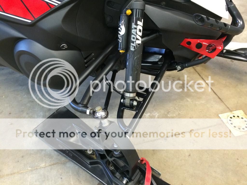

I experimented with placing a spacer on top of the spindle to increase the spacing between the upper and lower a-arm several years ago. The idea is similar to what Arctic Cat did with the tall spindles in the Pro and now Viper chassis. Several of the aftermarket a-arm setups like the Mountaintech 43, +2 forward arms utilize a spacer. I believe it improves handling mostly on rough trail by holding a better line. The problem with adding a spacer is that the increased spacing effects the caster and camber settings so there becomes a need to have the ability to correct for it. I made offset spacers in an attempt to correct for the changes. Utilizing the Hygear Slicast upper a-arms for the added adjustment would allow for increased balljoint spacing.
Mountaintech 43, +2 trail a-arms

I believe the JRE spindle does just that, my A arms have much wider spacing than stock

Not sure what teh spacing is, could measure it. The A arm spacing is much wider than stock is all I was pointing out, like the new Yamaha Viper.
I run no skid plate and have never had any issues with ground clearance, over 2k miles on them, they transformed my sled into a usable sled. I use 18.25" fox shox so front ride height is almost stock, even though the lower A arm is 1.5" lower than stock, plus the stiffer front shocks keep the nose up which made going downhill fast or riding in the rough a pleasure rather than a panic..
