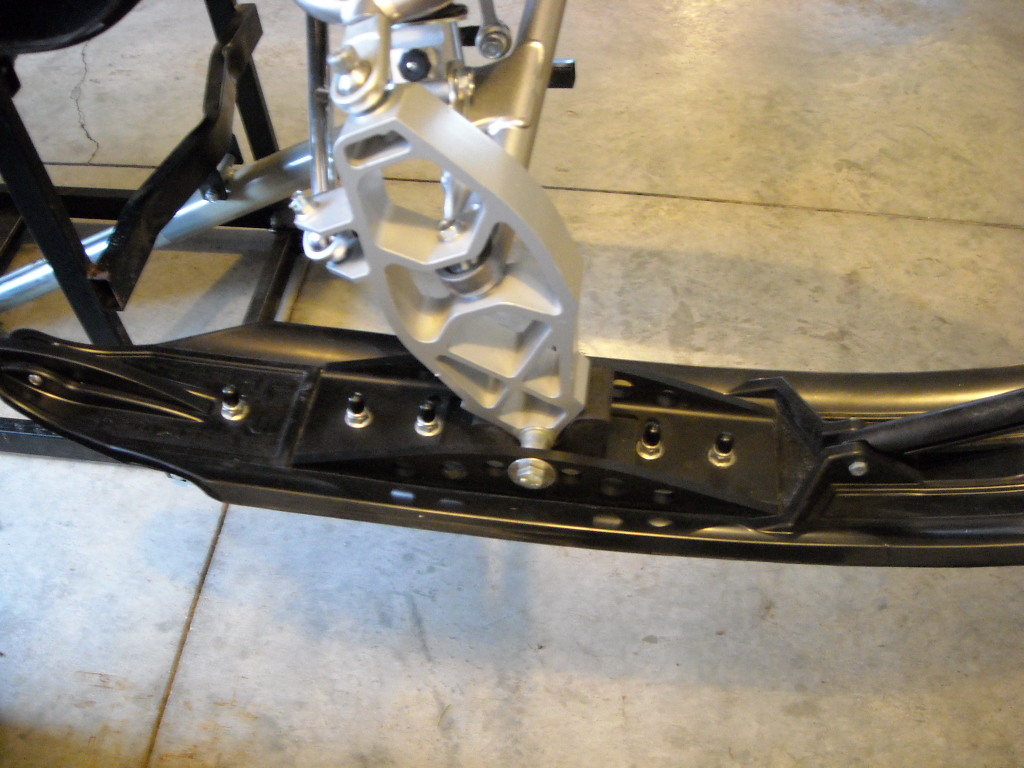

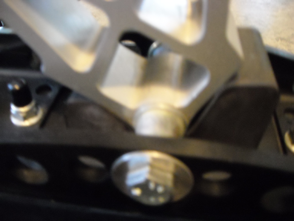

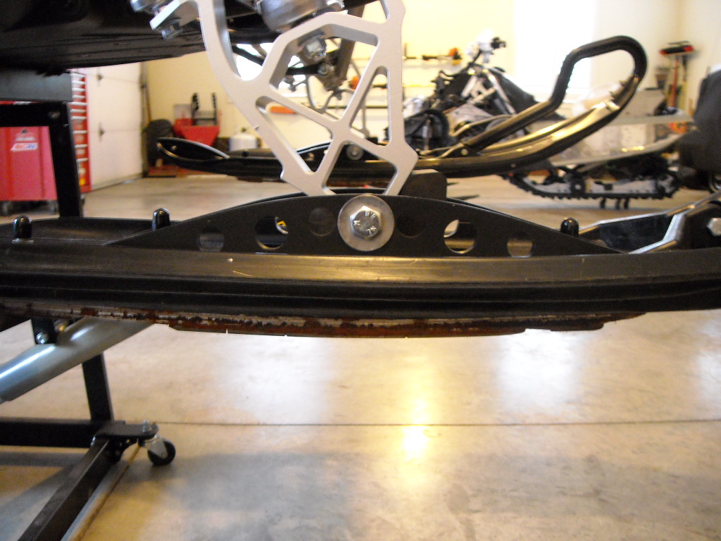

No shimming required, just bolted on and go. I am using the rocker plates as well. The rubber stops are completely different than what you have described, they are about an inch higher on the front side of the spindle.
Here's some pics, sorry about the quality.....

Sledhead0 has his mounted one hole back from yours Easy Rider...could that be the difference?
That wouldn't make any difference on how the rubber would effect the ski attitude. The different mounting holes just change the weight distribution and effective wheelbase. I tried mine in the back hole and didn't like the handling as well as in the centre hole.
Thanks very much for the info Easy Rider! I got my new rubbers in today and they look like they will work. They are similar to yours however still a little different. Not sure why but I do think they will work out okay.
