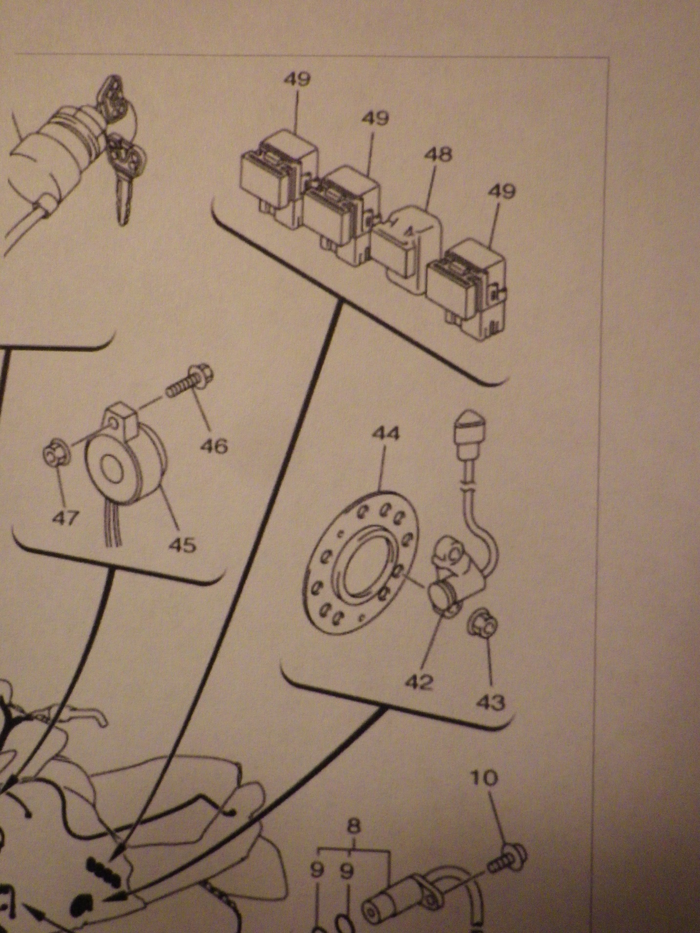

There is a post on the APEX forum about frozen fuel relays. I looked at a parts diagram and found 4 relays...3 the same and one different. Does anyone know which relay is fuel and what the others control? They are only called out as relays in the diagram. Thanks

It should be the one closest to the bulkhead of the sled. So when you're sitting on the sled they are by your left knee and it should be furthest to the right.
Cycle the key while feeling each relay. You will feel the click and that is your fuel pump relay.

Thanks Erroll... sorry about the delay. Just got back from the U.P.... The relay on mine was the easiest one. It's on the outside.Erroll said:Cycle the key while feeling each relay. You will feel the click and that is your fuel pump relay.
