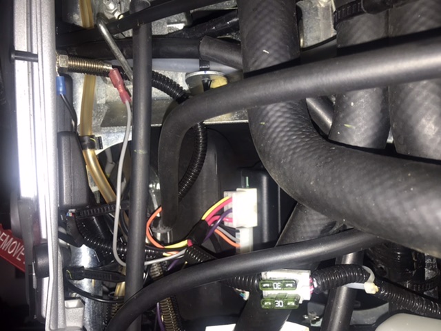

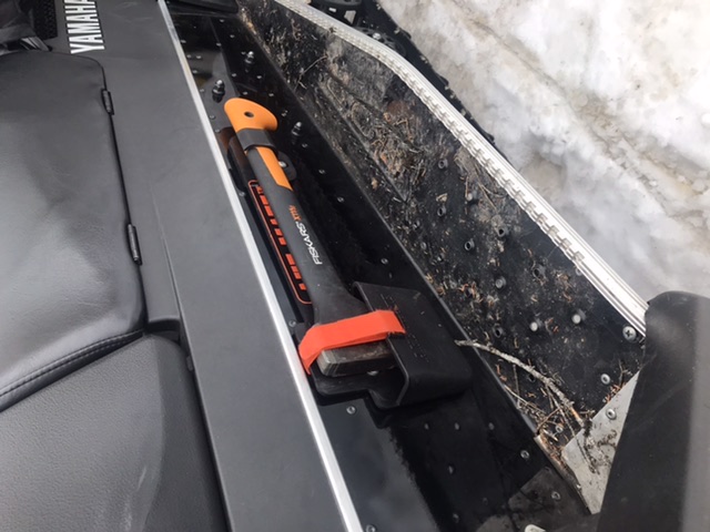

Let’s see some of your VK Pro mods, share your ideas. I have Pro 2 and there isn’t that many accessory on the market. I installed a vehicle auto start on my VK pro 2, I tried to at a video but was to big for this post. But you see in the pic the module and hood pin switch. I also installed an atv Kolpin gun boot holder, atv Kolpin chain saw holder, an axe mate. On the dash I have installed and wired in a Garmin 276cx, Garmin Inreach (ram mount) and a iPhone ram mount. I keep a safety throw rope around my handlebars ( it’s been there now 3 years and has never got tangled up). I took off my handlebar pad cover and stitched on a glasses pouch to hold sunglasses and amber glasses.
Some this that I have improved on for my own use is pantyhose over the hood vents to stop snow going on the engine causing steam and frosting up the windshield, and a pre air filter pice placed over the front grill for the same purpose of snow ingestion. I also extended the coolant overflow hose, installed scratchers and dropped the rear suspension to the bottom mount holes for better traction in deep snow. I keep a plastic shovel, Liter of oil and a length of rope under the hood in front.

I have a few questions for you. Is your auto start programmable so that it can start the sled on a timer and then shut off also. This would be one way to deal with cold starts when AC is not available. Sorry if that is a pretty basic/naive question but I don't know the first thing about them.

Yes the auto start is programable this is why I installed it. I keep the fuses out of the system until I want to use it because the module is always powered up looking for the start single. The battery is not big enough to handle the drain when parked for an extended time. So when I go to the camp I put the two 30amp fuses back in and set the auto starter for cold weather mode when I park for the night. The auto start I used is intended for a car of truck but I was able to use it with little change to the install instructions. The biggest change was to how the ignition was wired. The auto start I had was for a power feed ignition and the vk is a ground feed ignition, what I did was wired in a grounding relay from the auto start module. I think that they're companies out there the sells auto start for snowmobiles. I will try to upload a youtube video and post a link.

What size is the Fiskars axe, we have a 28 1/2 inch Fiskars and it is just awesome, for clearing small trees etc it is the best.

Pulling the fuses on your cold weather start is bang on as these things are always pulling power, even when inactive, the ECMs are always looking for juice. I have a few and every vehicle that has one also has a master switch to kill all power from the battery, does not do much for starting but battery never gets drained. Thanks for your time and sharing your ideas. Bearman
