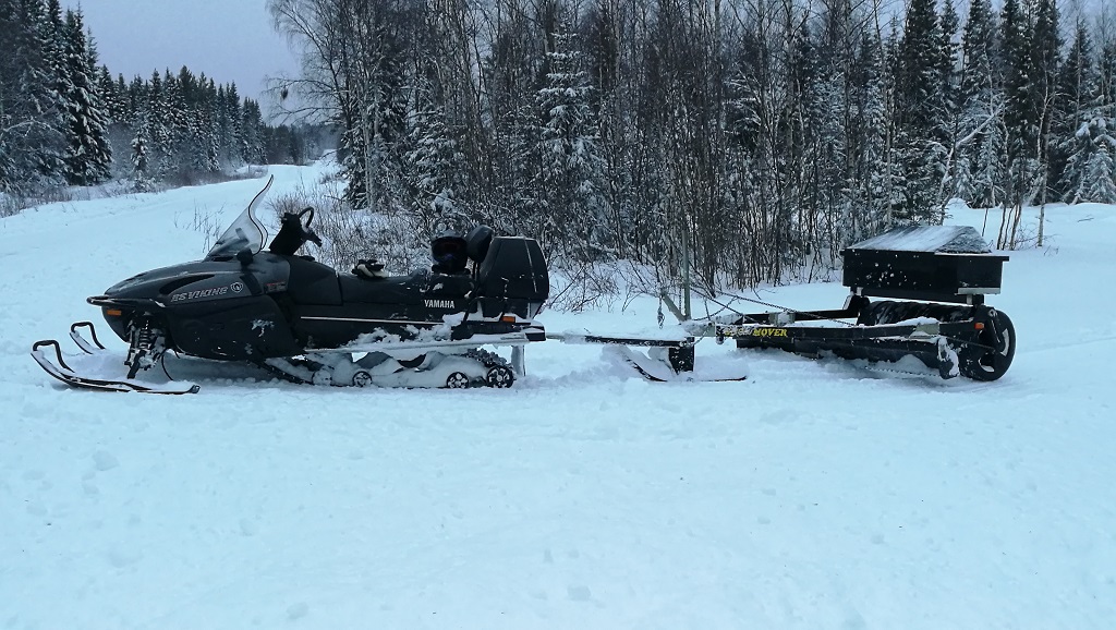

Greetings from Sweden.
I bought a 2015 RS Viking Professional this Wednesday.
I knew that it had a Super Wide Kit mounted on it and I had previously seen the kit advertised on blocket.se (Swedish craigslist). I have seen that this has been discussed here before so I thought I let you know what I know.
Below my Viking can be seen with the kit mounted. The ski stanch with the kit is about 1150 mm (45.3 In), in Sweden the original was 990 mm (39.0 In) in 2015 and I think it was 975 mm (38.4 In) in the US.
The picture below is from the advert on blocket.se and it says that the kit is for 2013 and newer machines and the part number is SMARSVK10KIT13R. The mounting instructions in the picture is written in Norwegian and as can be seen the kit consists of Yamaha original parts and two custom made brackets. The A-arms and tie rods are from RS Venture, so if anything is bent it is easy to buy new parts.
This kit has an ordinary price of around 3000 SEK (361 USD) but are now selling at 1595 SEK (192 USD). For that price you will almost not get one of the A-arms included in the kit, value for the money I would say.
Now for the custom made brackets, they are used to extend the upper shock absorber downwards to get the right ride height. See the picture from my Viking further down.
Since I have just bought my RS Viking and has not been riding RS Vikings before I can't say anything about handling.

I have nothing to compare to since I never have ridden a narrow RS Viking and I have only done 150 km (93 miles) with it and then most of the time pulling a trail groomer. With that said the groomer has sometimes pulled the Viking of the trail and also get me stuck from time to time and I have never ever felt any tendency for it to be tippy or unstable. It feels really stable I must say.
An added bonus is that the groomer is 120 cm wide and the same is the Viking, so where my skis go the groomer most of the times goes.

The trails here around Norderåsen - Häggenås - Österåsen and Munkflohögen are so narrow that it is not possible to use any wider groomer then 120 cm. I run both ways so if possible I make the trail up to 240 cm wide. I am loosely planing a trip up to Sacrifice Valley since a colleague has a cottage up there but I looked at www.skoterleder.org and it seems to be missing a lot of trails between here and there so I don't know the best way to get there.I have the same groomer, but 150 cm wide. Have you any weights in the box over the rollers?
My setup looks almost like yours, but I ride the VK540V. You should take a trip to Offerdal and ride the trails that I groom.
EDIT: No weights in the box, just a spade, an axe, some other tools and some fire wood in case I want to stop and enjoy a small fire. I flipped the wing upside down yesterday and only used the roller and I think the wing is the heaviest part of the groomer, but I might have gotten water inside the blades since they are hollow.
