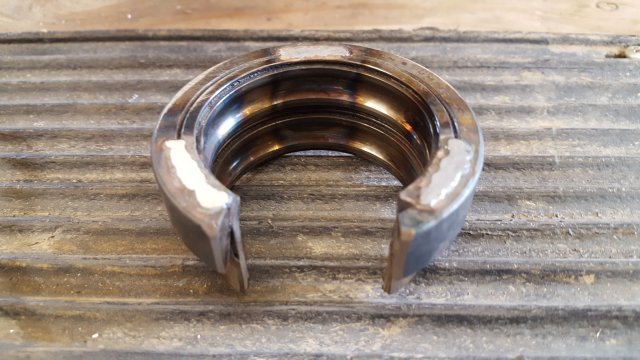

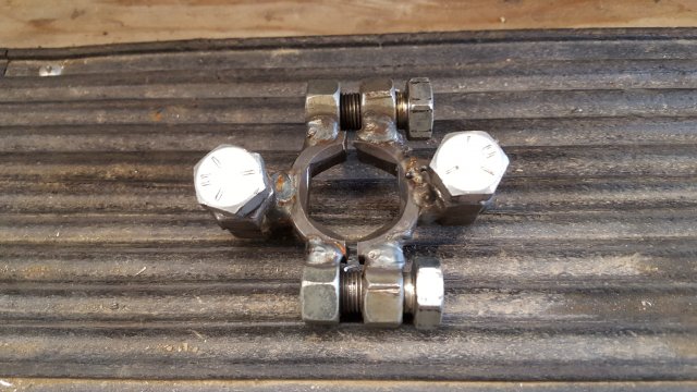

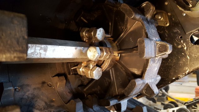

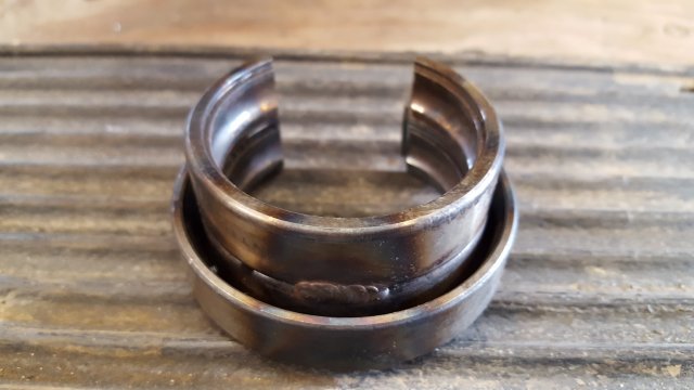

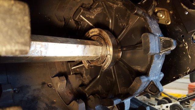

As far as getting the Wahl drivers in the correct position...if you're off just a little, there is a way to move them without tearing the sled apart. You can make a relocation tool out of the very collar you're asking about! Split it in two and convert it into a clamp / pusher assembly. I've had to use this tool that I made twice! It's still a bee-otch, but it's better than ripping your sled back apart!
You will need to notch a flat piece of steel (at least 1/2" thick) for the pusher bolts to push against, or make a collar out of old bearing races, otherwise the bolts will just cut into the driver and not move it.
