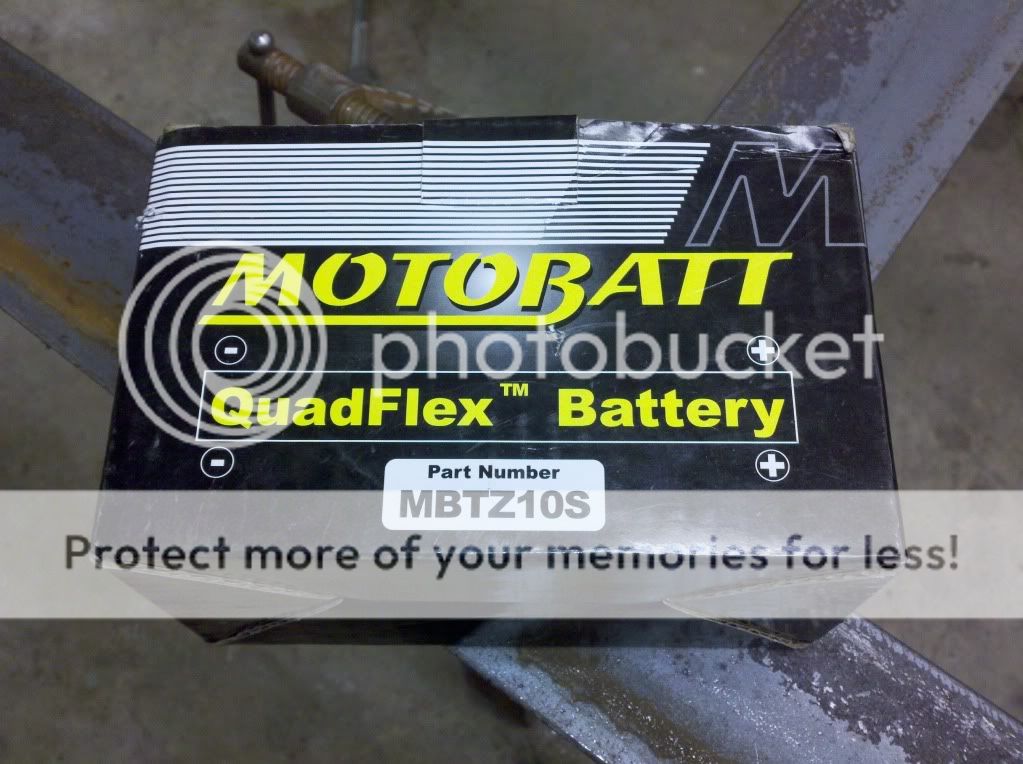

Want to cut some weight on my XTX
I'm happy with my cheap battery :Rockon:
