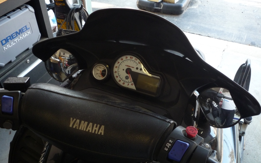

Same for me on temperatures. I found a 22mm sender kit at Royal Distributing that worked with an analog gauge from Princess Auto- probably your cheapest option and it works fine for me. The gauge even looks stock.

YammyRX1, I'm glad you stated the size, for some reason I was thinking 18mm, is that the Koso sending unit?, if so I believe it's cheaper at the Koso Canada website than at Royaldistributing, I have been thinking about ordering the gauge and sender from them.
It's a nice mod, I don't know why they would ever have a sled without a temperature gauge?, even my 08 GSX, I had to buy the module to turn on the display already installed in the gauge?, WTF?

Yes, it's Koso. The gauge really gives you piece of mind especially on those warm days.
