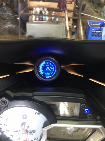

This it the set up I'm doing in a few days , love that upFrom a fellow TY'er 02ViperMody who recommended this Prosports digital temp gauge, this requires holes to bolt unit on the dash pod however, works great!

I have the same one works very well no vibration. You can see it the hole time you ride even in direct sunlightFrom a fellow TY'er 02ViperMody who recommended this Prosports digital temp gauge, this requires holes to bolt unit on the dash pod however, works great!

Fully installed and wow I love this, what temp should I be running at when warmed up? Mine is in degrees Celsius, I couldn't find the switch wire so I wired the Orange into the low beam shocket on the headlight plug in, also put the ground up there for the gauge. All works well and very happy with the product. Also I habe 50/50 premix coolant and and going to add water wetter after a few test runs .

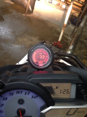

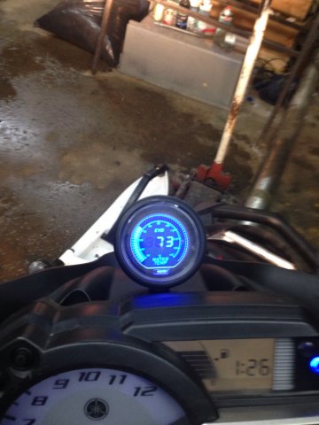

So I took a run today up across the lake for an hour and it was about 6 inchs of fresh snow and my temp was running 76-80 degree Celsius, to me that seems a little high. Using 50/50 coolant and water wetter, any ideas why so high? Followed ulmers instructions for the placement of the T and sender.

Since you don't have an auxillary cooler, and 6 inches of loose stuff so you may be working a little harder, I would say you should be happy with 76-80. Perfectly normal temperature.
