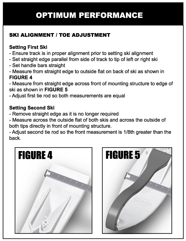

Sean/Nick,
Got the skis mounted, just had a few questions.
1.) When you guys did all the nytro/curves ski testing last spring, did the nytro have the upper balljoint mod done? or was it all stock.
2.) How much toe out/in did you set for - and how far ahead/behind the spindle did you measure to get that spec.
3.) did you need to shim the rubber bumper at all? skis sit level, but I had really good results with 1/4" shim at the back with the c&a's, did you guys need to do this also? she's a tight fit as is, not sure if I can squeeze a shim in there.
4.) did you do any testing with a wider ski stance via spindle bushings? I'm currently running a homemade 1/4" bushing on the inside & a 1" bushing on the outside of the spindle.
5.) skis look AWESOME!! Hope they work as good as they look.

BLUEBALLER said:Sean/Nick,
SaaaWEET Avatar!
- The testing was done on the Excell Motorsports Nytro. I do not believe any upgrades/changes were made to the front end except for a full Hygear dual rate spring setup.
- We recommend .25" toe out on all Yamaha's. Because the skis are .25" wider up front, your front should measure .75" more than the back after you set one parallel to the track. You can use the flat area of the ski for the rear measurement and set your tape right across the mounting structure on the front. See the attached photo for reference however, disregard the setup instructions.
- We do not recommend any shimming. The rubber has a built in shim when compressed and installed with our skis. You'll find they are much more stiff than a factory rubber which is exactly what our skis need to perform their best.
- Again, I don't believe the Excell Motorsports Nytro has any front end modifications other than shocks and springs. We would like to spend some more time on it this year and possibly develop a solution that is better yet!
