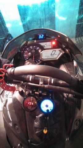

Here's my install
Temp gauge install
Temp gauge install

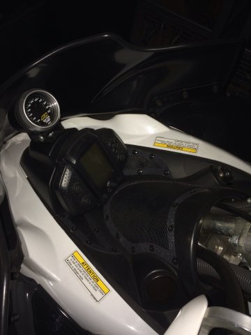

- 2011 Nytro MTX slowly being modded
2005 IQR Trail Converted
Koso blue slim line & plumbed it right into the T stat housing.
