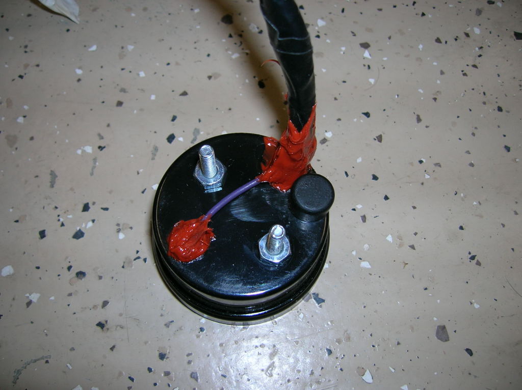

Thanks for the info I am working on my install today, I have a friend making me a slpice I will see how that comes out . I bought the cybertyne gage and it looks good,But I had to seal up the back to make it water tight, Nice thing it has it it will flash if you get to hot and you can set at what temp you want it to flash.

I dont have it done but here is a sample of what it looks like, I will post more when the install is complete.
How and where did you seal the back of the guage?
