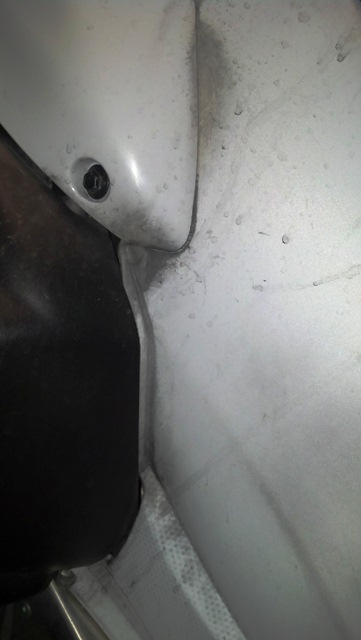

This is what I am struggling with to clean. Hard to tell in the picture but I am holding the white side panel off of the gas tank panel to show the black line. This is clutch/belt residue ground into the gas tank panel where the side panel touches it. I have tried Simply Green and S100 with no luck. Anybody else dealing with this on white panels? Thanks, G.B.
Like Yamahas said Get a magic eraser.If that doent work you will need to do some sanding
michdog2011
Magic Eraser - works on all

Love the white but struggle to keep it clean. Does anyone's white Phazer look like this after 300 miles of riding? I am using the new or updated Phazer belt and I am thinking it might be a softer compound???.
G.B.
G.B.
Have you tried washing the belt with a mild soap and water? I've done this using a plastic bristle scrub brush, and can't say whether it prevents the kind of build-up you're seeing, as mine never seemed to be that bad, but I've read that new belts often have a film on them that should be removed. The film is a residue that is left from the manufacturing process.
Also, it helps a lot IMO to take your secondary apart and clean it. I also polished the helix with a mild billet aluminum polish (Mothers). Clean/remove as much grease as you can and don't forget the jackshaft. IMO, a lot of excess grease gets slung when the secondary is spun up.
Doing these things has helped in my case, but I still see some (although no where near what you've shown in those pics) dirt sneaking out from underneath the plastics occasionally.

OVR4D,
Thanks for the suggestions. It gives me a couple things to look at.
The belt has approx. 1,300 miles on it and before I put it on I scrubbed it with Simply Green and a Scotch Brite pad. The sled has 1,500 miles on it and it has looked like this after each since I have owned it.
