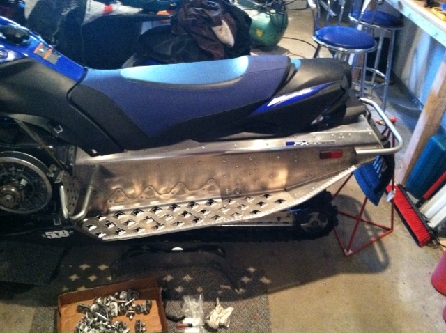

I think we needs some pics of this rocket. Maybe it is a retired race sled.

Looks like a 2008 with shox and windshield off a 2009 SE.

How can you tell its an 08 from pics? Well the guy lied cause he told me its and 09
Hard to tell from the angle, but it looks like 08 spindles and a 09 subframe. If you look at the side of the spindle and the 3 points (upper ball joint, lower ball and ski bolt) are in a line then they are 08's, if the ski bolt is slightly rearward of a line between the two ball joints then they are 09 or newer.
For the subframe it was mentioned above how to tell the difference, but since so many sleds have newer subframe's I would not use that as a indicator.

dremmick said:How can you tell its an 08 from pics? Well the guy lied cause he told me its and 09
I can't say for sure. If he said it's an 09 it might be. Parts can be swapped pretty easy. He has obviously swapped some of the parts since those front shox are not stock on that sled. Those shox came on the SE starting in 2009 but the SE has a different tunnel so that sled isn't a SE for sure.
