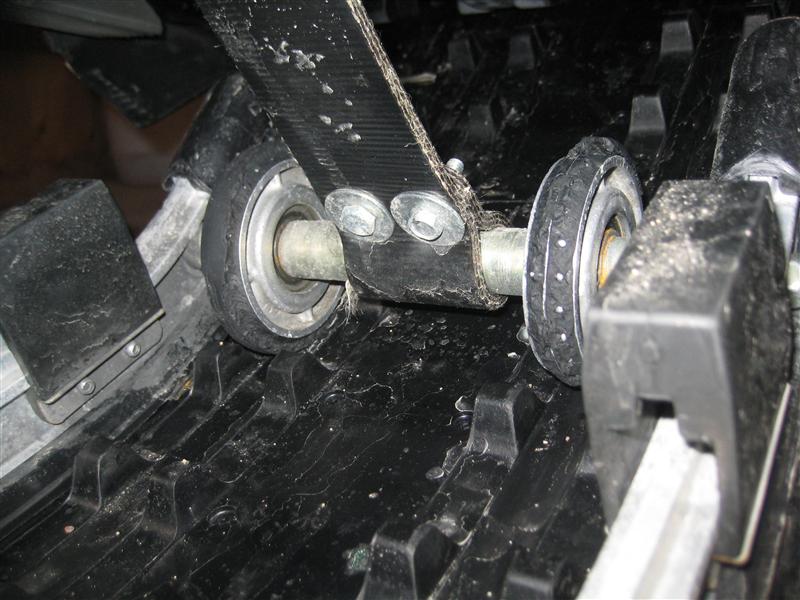

Parts needed
1 shaft from an old suspension that held wheels between the rails.
1 pair of the small aluminum wheels that held the track up over the suspension on the 1990's snowmobiles.
Remove the front limiter strap bar and use the new one with the wheels in the same holes. This one has almost no wear on the front of the sliders after a year of use. The sliders are worn through near the back.
The original hyfax screws had the heads worn off before the sliders wore out. There was also a lot of wear to the rail caps as you can see. The wheel with the rubber worn off is over 15 years old, and has done very well.
