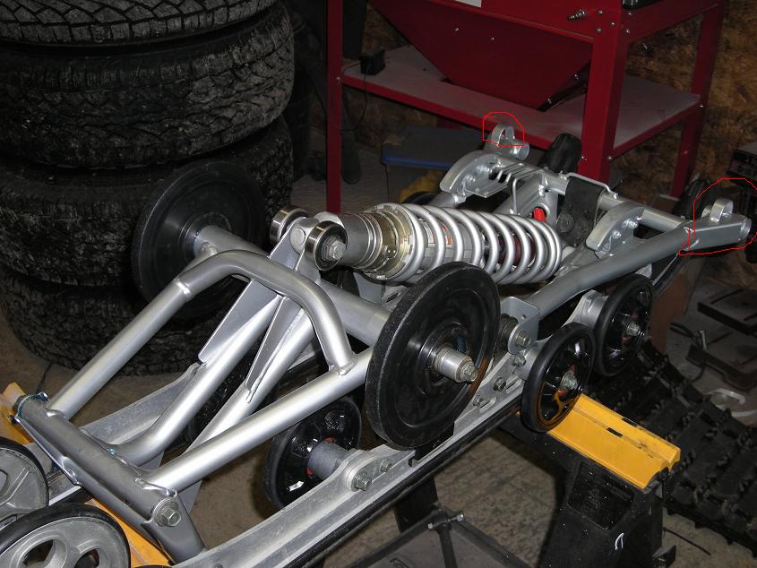

Good news, thanks for going to the trouble of posting the pic. Did this net you anymore top end? Are there any noticeable traction gains? Does it bridge the stutters any better?

170plus said:i have a 128" x 13.5 hacksaw on my 06rtx with tracksusa extensions,almost 4000 miles now ,no issues except the track grabs the flap once in a while,im just too lazy to strap it to the bumper like i see a lot of people do,no studs so no problems
What idlers are you using?

SledFreak said:170plus said:i have a 128" x 13.5 hacksaw on my 06rtx with tracksusa extensions,almost 4000 miles now ,no issues except the track grabs the flap once in a while,im just too lazy to strap it to the bumper like i see a lot of people do,no studs so no problems
Those look like the older style Yamaha idlers.

i used those idlers the last 2 years(had to machine mounts for smaller bearing size),this year i purchased all new mounts nad wheels,found the old style aluminum wheels to hold ice build up very bad,not good for my week long trips,not long enough to notice any bridging of the bumps,hacksaw has excellent grip on groomed trails,small top end gain on ideal groomed trails,every little bit helps,running the 13.5 track you will have to widen the metal loops on the top of the front suspension arm,the 14 is fine stock,other than that there is really no changes to make other than the extensions

Thanks, for the pic. I haven't decided if it will be a 13.5" or 14" as of yet. Either way I will widen the hoops, just to be safe, then it will be off to sandblast and powdercoat for what I hope will be the end of all the rust. I have lost count of how many times I have painted this skid!
