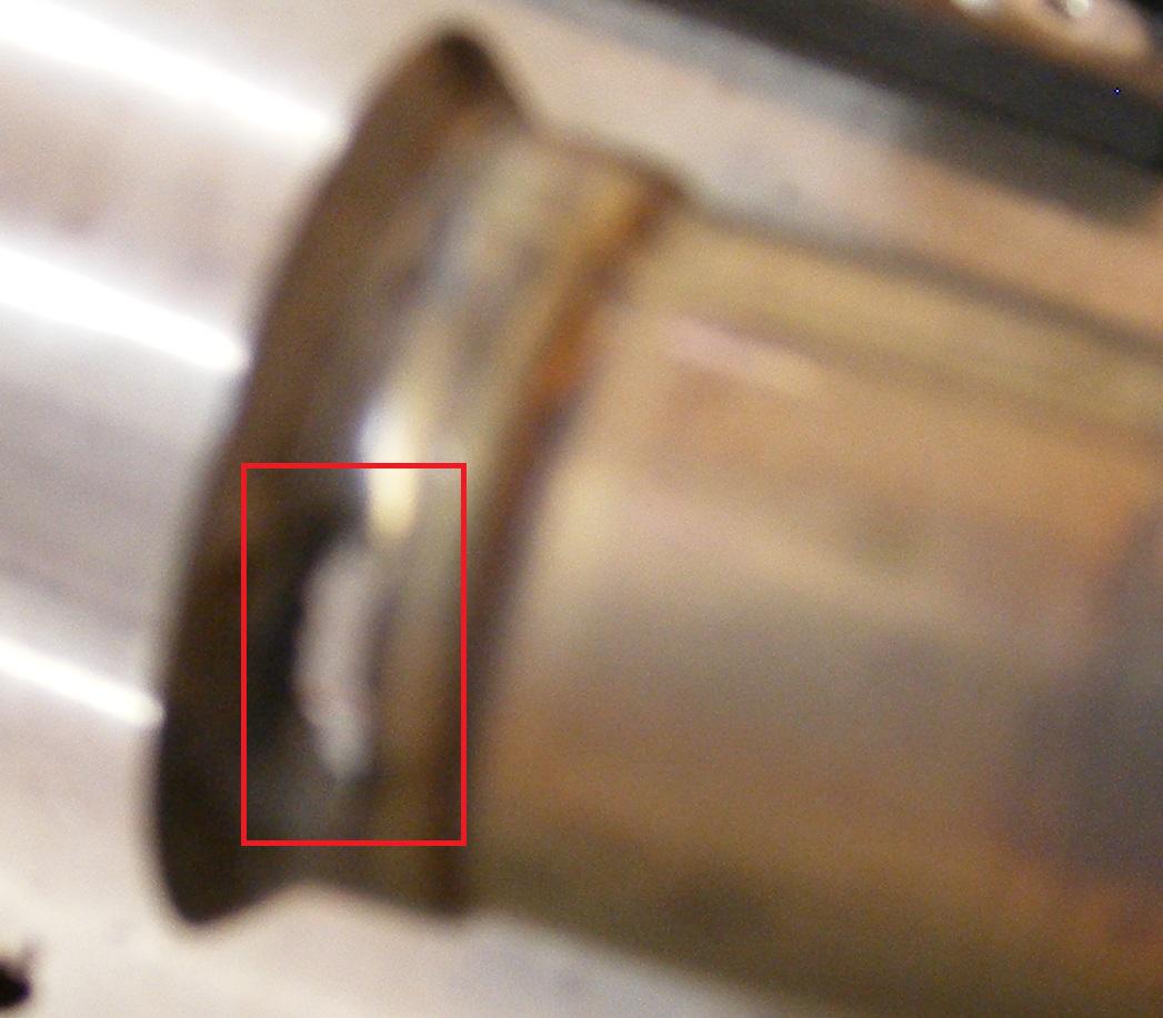

Wow I thought mine were bad. As you can see the damage mine incured was not nearly as bad, but enough to consider them toast as they will leak and eventially break. The pic is a little (ok a lot) blurry but inside the red box is the wear hole. Can't really see it until the clamps are off. At least I didn't see it. Before I got the clam off I was jumping up and down, comending myself for not riding on the Sunday after I noticed the sound. Took the clamps off and, well lets just say there were a few less pops in the frig. after that night.

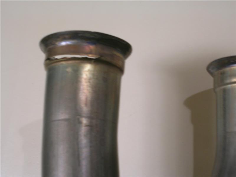

Here is a picture where mine is cracked.
Is that cylinder #1? Mine was #1.
favarcat
#2. The second one in from the left. The picture is actually taken from the bottom. The clamp on the far left was completely loose and turned down, but it wasn't cracked yet. Had 2 gaskets that were almost gone, one half gone, and 1 not as bad.
