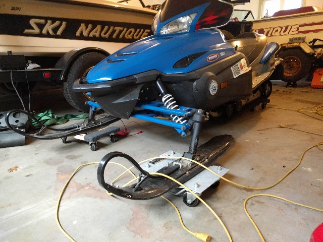

Anything I should be looking to upgrade on the sled? I don't like the non-original paint/graphics. I think the skis have been upgraded, maybe some other things...

http://www.worldclasswraps.com/16-RX1-Vector-Yamaha-sled-wraps.html
That seems like a different color blue than I'm use to seeing , but I don't know much about RX1 .
I posted an example of a graphics wrap. I'm sure if you do a good search you can find one cheap!
I know I would clean the clutches and check the idler wheels real good . Change the oil and the Chain case lube.
Very nice ski's they should work great. The shocks look to be set right ( you want the "A" arms level ) maybe measure the sway bar. I believe RX handled better with a 13mm bar.
Barn of parts has the sway bars . Get the front off the ground and see if there is play in the front suspension . Grease it all up and pray for snow this year. ENJOY !

Can't thank you guys enough! With a little elbow grease, it was running. I'm going to add a fuel shutoff when I get around to it so I can run it dry; I'll probably fog it next summer as well. I'm really hoping the gauge was off; I tested two cylinders hot, and both came back with a reading on 90PSI...so 110 cold, 90 hot...hmm. That doesn't add up to me.
DGZRT -- thanks for the comments/maintenance items. I'll definitely get on that this weekend. oil and filter were definitely on my list, but I'll check the clutches and wheels, change the chain case lube, and get my grease gun on it. The previous owner painted it blue (it was red from the factory). I would have kept it Red, but that's over now.
I just measured the sway bar- 5/8" diameter or so, which is about 13mm.
