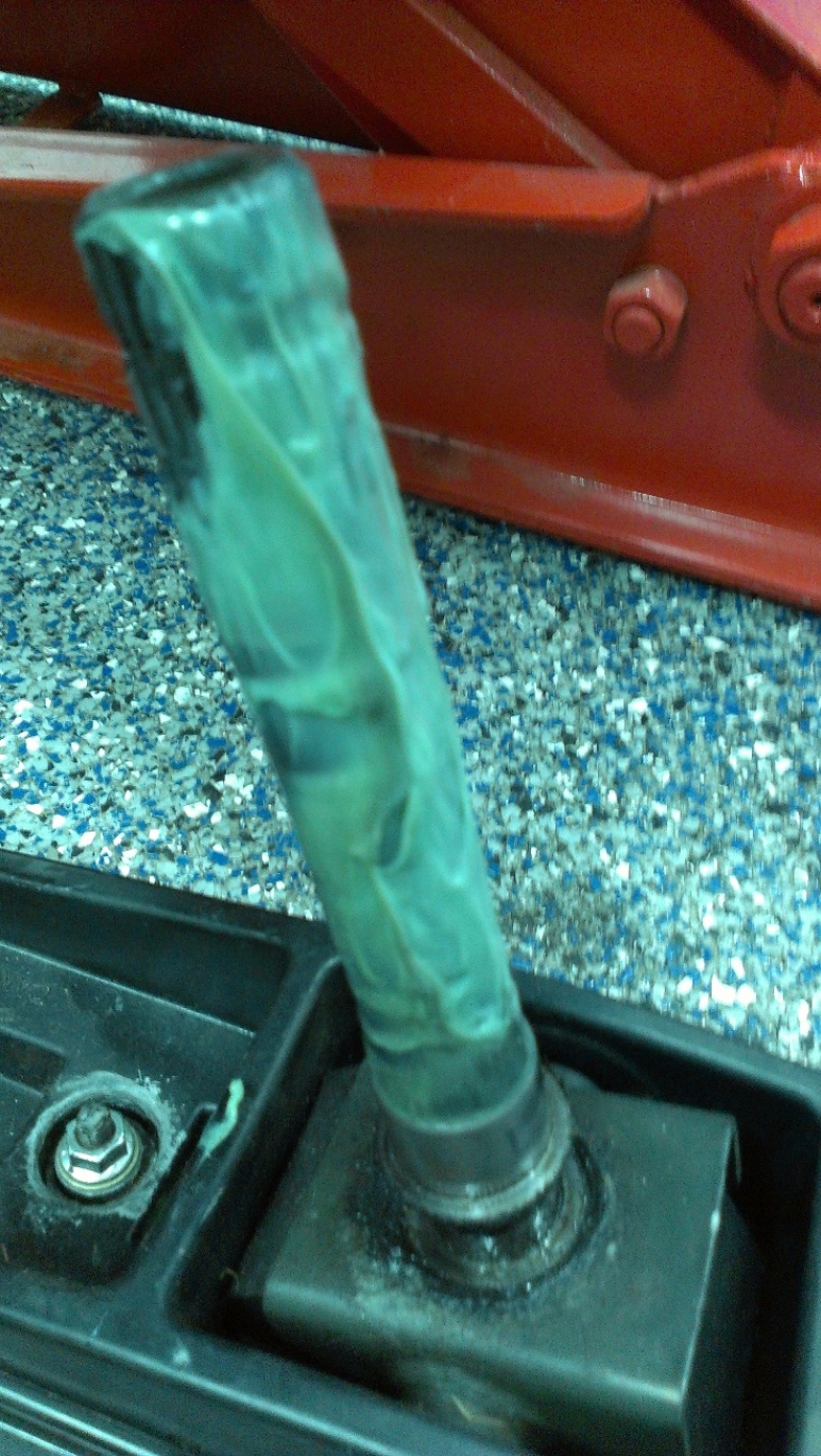

Be sure to chaeck the interference on your bushings
I ordered and installed oilites last year and I dismantled the spindles today to check them. The oilites I bought at the time did not go in as tight as the old plastic ones I had removed, so I bought a 1-2" micrometer and measured the OD on the old and the new. The new oilites were smaller so I sent them back only to have them returned with a "they were within spec".
I went ahead and fitted them against my better judgement and marked the spindle as well as the bush with a center punch to see if they would turn in the spindle. Today when I pulled the right hand spindle the lower oilite bush in the spindle housing came out with the shaft as seen in the photo. The top oilite bushing had turned almost 180 degrees and had no real interference in its bore to speak of.
The bulkhead bushes I fitted felt fine when I was installing them.
So Ill be ordering another set from a differnet vendor today and hope their spindle bushes are sized better thena these were. I will let everyone know how the new ones measure up.

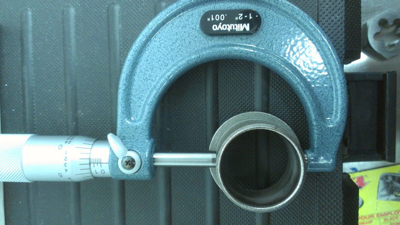

yamaha convert
New Yamaha bushes
My Yamaha oilite bushes arrived today.
The new Yamaha oilite bushes measured the same as the new plastic bushes I had from a spindle I bought last year. The surprise was the the Yamaha bushes were .003" bigger than the aftermarket bushes I had purchased.
My concern when I saw this was that the extra interference might make the ID of the bush tight on the spindle shaft. This was also a concern - reason from the previous vendor for why their oilites didnt have as much interference. So I knocked them in. They were firm going in, and the spindle went in fine.
I have attached the pics with the measurements so others can check theirs if need be.
