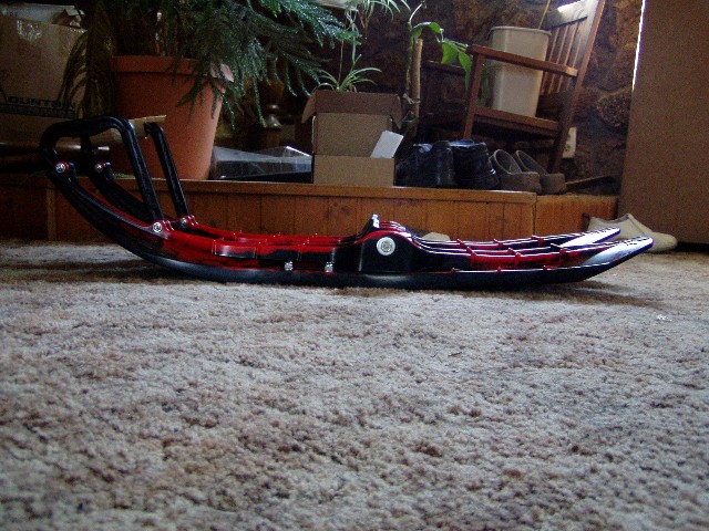

Here's the skis I will have on my RX-1 mtn and the wife's 900 RMK. I bought them for $390 a set complete with carbides and spindle kit. The skis are PPD model X-MT and are 2lbs lighter than Simmons.
Jim
Jim
