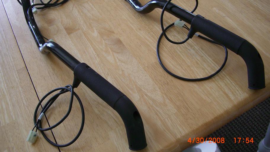

The Std FX Nytro and Nytro RTX are different. The bars on the RTX have a taller adjustable riser and straighter designed bar. The Std Nytro bars have shorter fixed riser and a bigger bending or taller designed handlebar. The 06 Apex bars fall in-between on the bend, They are taller on a Nytro RTX and shorter on the std. FX Nytro.

The 06 bars were not 1 pc.. They had removable hooks. You can't put the 06 grips on the 08 bars. The 06 grips were the best feeling grip Yamaha has ever put on a sled. I hate the the raised rubber lines on Yamaha grips. The 06's may not have put out a ton of heat but the grips themselves were 10x's better when it came to the way they felt on your hand. Why the 06 grips make more heat on the 08's? I don't know as I have not hooked mine up yet.

I have run stock bars on short track Nytro and then changed to 06 Apex then to handlebar kit updated 07 bars for apex and work great.
I like the mountain bar and little bit higher with 1.5" spacer/bolts on my short track.
Not to crazy about mountain nytro handlebars!
Way to far back so climbing hills feels like you can't control it and flop it over easy.
Handlebars are about 4"ahead on mine.

If I remember correctly - the 06 grips were originally wired in series. When everyone complained they weren't hot enough, Yamaha came out with an update kit with new bars & an adapter harness to connect the 06's wiring to the updated (parallel wired bars). This combo was marginal also, then someone tried the old bars with the update parallel harness. While I've forgotten most of my Ohm's Law - the net effect was much higher current (due to the lower resistance of the series grips now being in parallel ) like 4 times as much - and finally - hot Grips.
There's much debate as to the long term ability of your ECU to put out so much more current than it was designed for. As long as you use your grips on low, you may be OK - but your taking your chances with a spendy part (ECU).
Measuring a set of grips(06 update bars) I got gave me the following result - each grip on it's own measures 7.7 ohms for 15.4 ohms in series. In Parallel they measure about 4.4 ohms total. 14 volts at 15.4 ohm = 12.73 watts while 14 volts at 4.4 ohms =44.55 watts . I assume the 08's factory harness is designed for parallel grips - putting on the 06 bars would in effect lower the resistance the same way. I using 14 volt as an example - I'm not sure what the actual voltage is since the newer Models use a pulse width modulated voltage to change the heat output.
