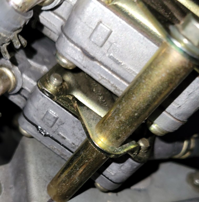

I have a 06 Vector question. I took apart both fuel pumps to verify they were clean. I did not take any gaskets off. One at a time and reassemble. I screwed it back together but not super tight, like when I took it apart.
The bottom fuel pump is leaking. Should I just tighten it up. I did not rip the gasket. Thanks in advance. viper7mi

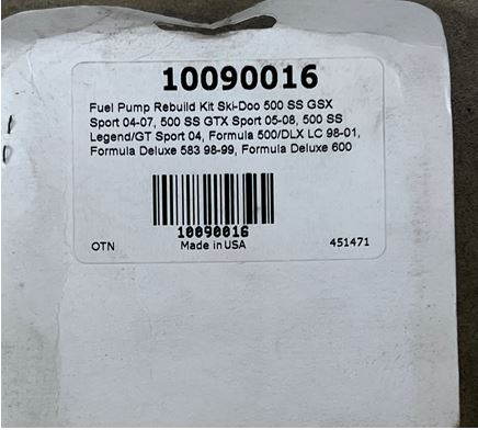

May just be a bad gasket. Not sure if they are the same but on my 03 RX-1, I removed and disassembled the pumps and was careful as well but did end up compromising one of the gaskets. Good news is that there is a replacement gasket kit but it's not available from Yamaha. It's a universal kit that not only includes the gaskets but also all the other components in the pump. I ended up purchasing two sets to completely rebuild the two pumps and bought the kit from Dennis Kirk. You maybe able to find it elsewhere using the mfg part number listed on the back:
