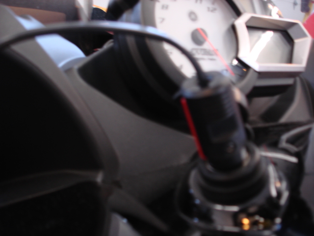

Good choice on the YTX20H-BS. It is the largest battery that will fit properly (6 7/8" wide x 3 7/16" thick x 6 1/8" tall) and it has 310 CCA which is 110 more CCA than the OEM battery. It is also 6 pounds heavier than the OEM battery but for me that is a fair trade off for the 110 additional cold cranking amps.
Also a good choice on the Optimate 4 smart charger. I bought the optional Optimate cig plug adapter and I wired my accessory socket direct to my battery with an inline fuse. Now I can just plug my Optimate 4 into my accessory socket to keep the battery charged.
Kevin Garceau
Thats a nice option - Not that taking the hood off is an issue, but if its on you dont have to worry about it falling off or scuffing.
Im going to look at that as well thanks.
