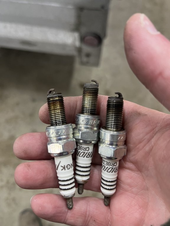

These have 8000 kms on them. I pulled them yesterday.

Got it, center carb main jet plugged by piece of fibery junk. I had installed new in tank filters last spring. Mabey should have blown out before installed. Anyway, runs crisp now. Thank you for your help.These have 8000 kms on them. I pulled them yesterday. View attachment 171398
