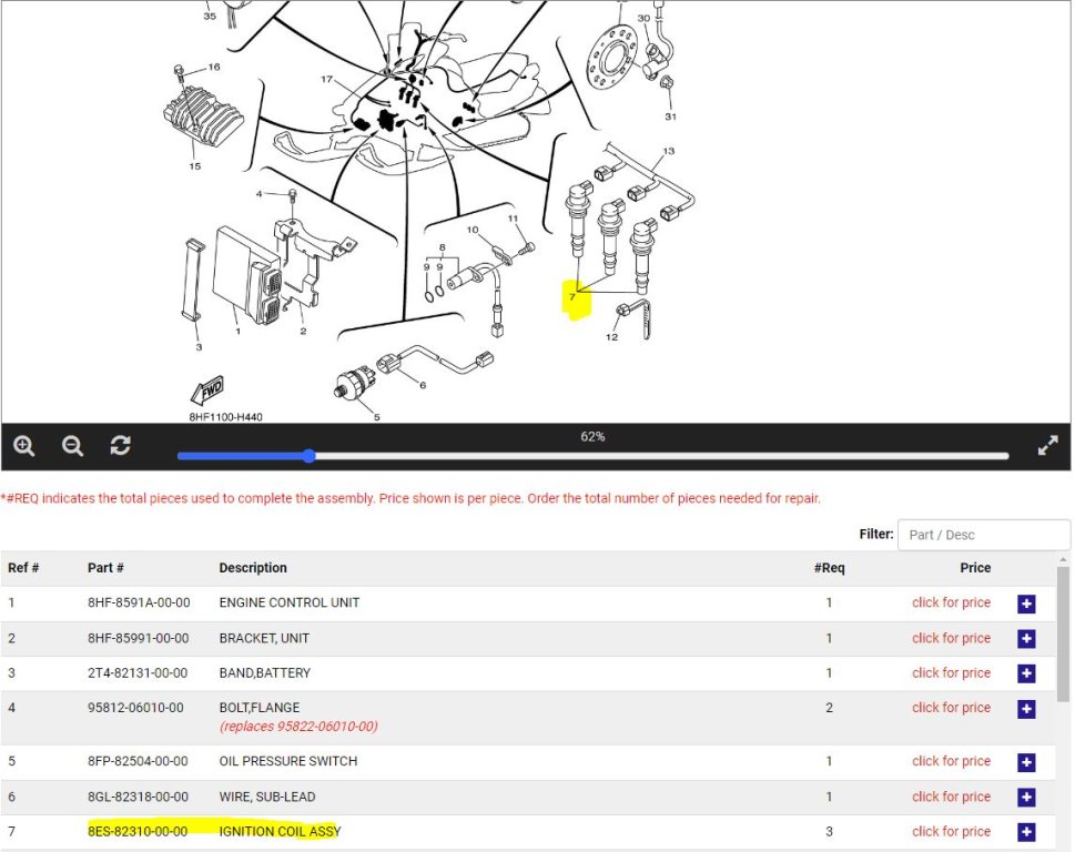

X3 with @MrSled as I was always very meticulous with the carbs on my RX-1 where each year I would disassemble the carbs and thoroughly clean and soak the jets, needles, pilots, etc. and then sync the carbs but at around 10-11,000 miles I noticed I could no longer get the carbs to sync (ie. the lines of mercury were bouncing around inconsistently with each other) and it just didn't run right. Even though I could see thru the smallest of the jets, I came to the conclusion that it was just time to completely rebuild the carbs with new jets, needles, pilots, etc. After doing that, I could sync the carbs where all four lines of mercury were level and reacting the same and she was back to purring like her old self.

Considering the three coils for you 09 Venture GT all have the same part number, they are not specific to a cylinder so not sure why mixing them up caused this unless one of them were bad and you were just moving the bad coil to a different cylinder.When I did the plugs on my Venture, I had accidentally mixed coils 1 and 3 by accident and it had trouble starting as well as rough idle and stumbling when giving it a little throttle.

I know when I replaced the two coils on my RX-1, all four of them were the same part number and they did not have specific cylinder to be connected to. When I checked the coils for you 09 Venture GT, it was the same. I would think if the coils were cylinder specific, there would be three unique part numbers for the coils; how can they have same part number if you need the coil for cylinder #1 and #3:

Using the parts schematic I posted, if you were to take one of the connectors (#13) and connect it to the wrong coil (#7), then I would agree with you.but the signal for them to fire get triggered at different intervals for each cylinder

Oh my, I see where I miscommunicated here.. what I originally meant was the connectors at the coil, not the coils itself.. my bad!Using the parts schematic I posted, if you were to take one of the connectors (#13) and connect it to the wrong coil (#7), then I would agree with yyou
