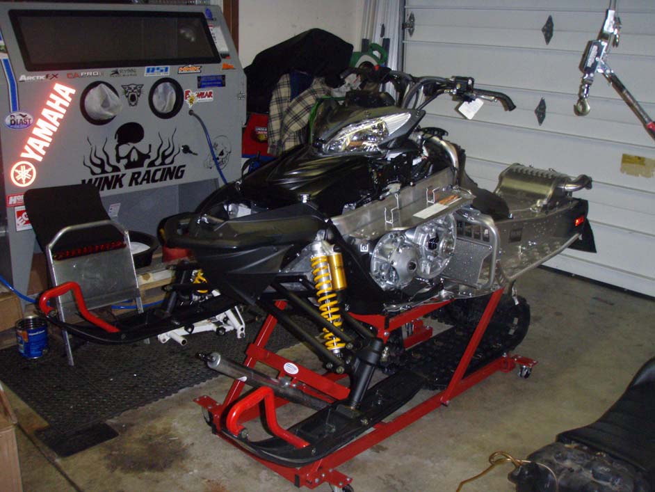

Well I have started taking down my 08 Apex 40th leftover that I picked up a couple weeks ago - it would be a long summer to just look at a stock sled and not do anything to it. Here are the plans, some of the parts are used and I cannot take credit for all of the ideas.
- CR Racing 144 Tunnel
- 144 Expert X Skid
- 144 x 1.5 Crossover Track
- Extro Drivers
- Boss Seat
- TJ's tunnel dump exhaust
- Pioneer Performance 45" wide front end kit
- Lightweight body kit
- Skis - still have to decide on which ones
- Speedo relocation
- Bar Risers
I will try to update the post as I make progress - waiting on parts currently, first Yammi 4 Stroke and cannot wait for next winter!!

what do you mean by "army" is it going to be an army themed paint job?
The body kit I found is flat black with rivets like an airplane, I am going to try to carry out the military theme.
yamaslob
For Risers you need to buy some FLY risers in black will look so good with that paint scheme.
Received the Pioneer Performance Wide Kit in Chrome - thanks TY classifides - waiting on more parts, will post some pics as the parts come in!!!!
More parts in and going to paint, need to take some pics!!! Tunnel swap to start very soon!!!!
It is almost Fall and I have a pile of parts and nothing done, never should have got a bike!! Parts are at the powdercoaters and I'm ready to get busy asap!!

Are the panels from Matt? I've seen those if they are, very kewl. Came from a Turbo sled?
He had the whole deal for sale, panels, tunnel, expert.
Need to see them pics, man. lol
