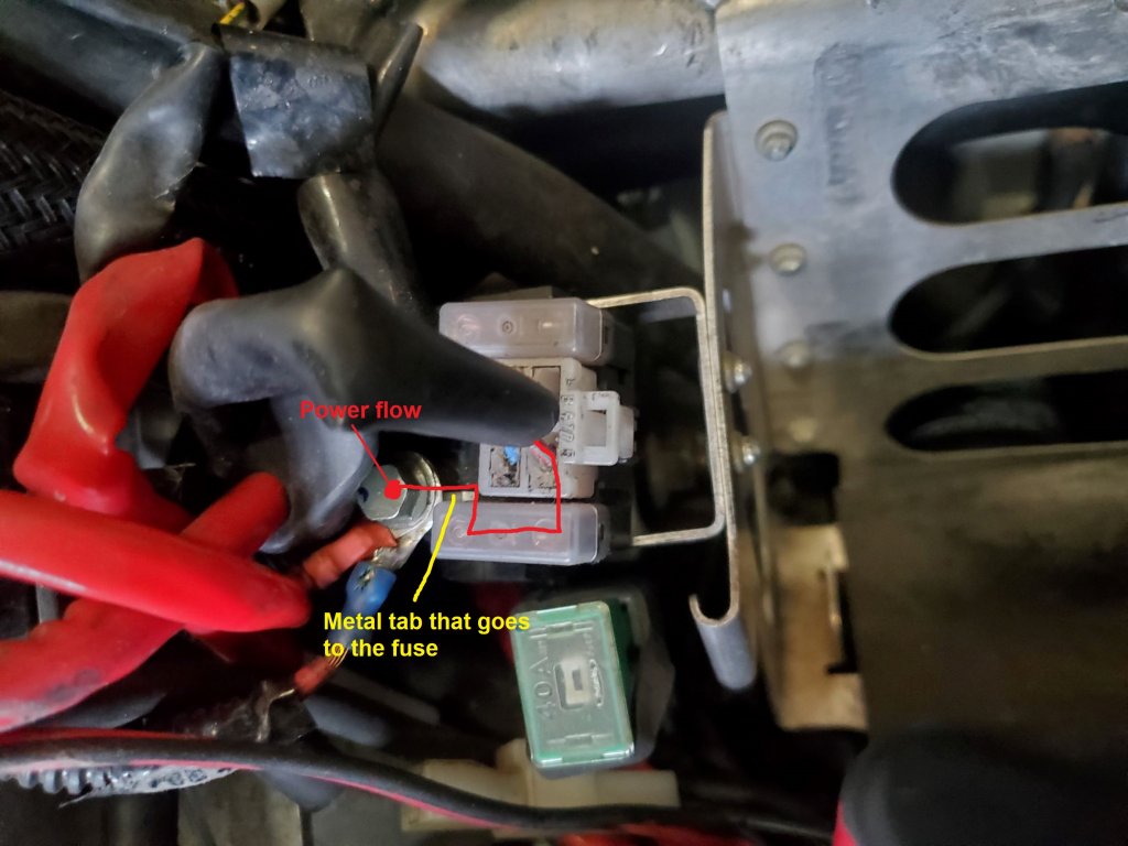

When getting a new starter relay make sure they give the correct one. The relay comes in two configurations. The look exactly the same but power the fuses differently. Only one fuse is used out of the two in each configuration. Double check the ringed tab to see which fuse it ids powering up. If it is opposite of the factory relay you can take it apart and swap parts around so it will work in the Apex.
