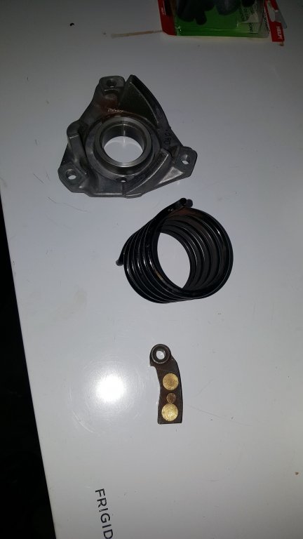

this is what I have for clutching!
primary spring bsb (blue silver blue)
helix 8bv31 6/1 wrap w w spring
weights 8bu 10

I'm pretty sure the "Yamaha stock clutching" is the MPI/Ulmer kit.

The MPI turbo kit did not come with any clutching when it was new. The MPI kit has washers that are screwed in. The springs are also red.
The ones shown are not the same cams.
