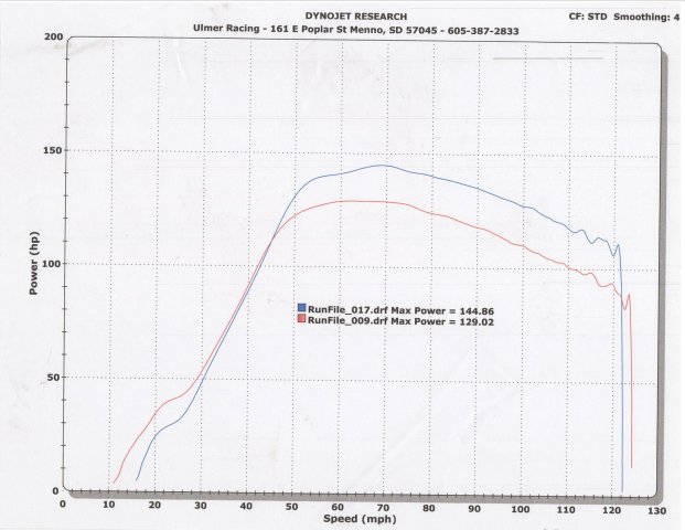

EVO flash 91 octane at 7#'s timing is retarded an limiter is 9750. 10.5#'s is on 110 race fuel but 7#'s is so much faster with stock head gasket then my 14 was at 12#' s with low compression pistons
Hate to tell you but if your set up at 7 pounds is faster then the 12 pound set up - the previous set up was tuned very bad. Allan is a great tuner and I'm sure its set up well now - but there is no 7 pound viper that will stay with a well set up 12 pound low compression viper. Pulling 4 degrees of timing is sacrificing a lot of power, and there should be 50 hp between the two boost levels.
Well when I have ridden both but I am going from memory from last year but I can compare them and with the gearing in this thing now a stock motor vs low compression the sled is night and day. The first sheet is the 14 at 9 & 12#'s the second is the 15 with 7 & 10.5 lbs. The 15 is making more track hp with 2#'s less than the 14 and it jumps quicker, The 14 barely made 113 hp at 9 #'s and the 15 is 129 at 7#'s that is 28 hp at the crank difference. then the 14 made 144 hp at 12#'s and this one is making 145 at 10.5#'s and this motor only has 140 miles on it and will step it up as it breaks in.
And remember #'s of boost mean nothing! I know several guys running 4.5 and 5 #'s through MPI trail turbos and are not getting more than 155 hp out of them on the dyno! Just cause your kit says 180 it does not mean that's what you get.
My take on this is that the high comp plus the billet compressor wheel makes this a very efficient torque monster. Chances are the turbo is now spinning much faster and throughputting much more air.
Makes me jealous. If MPI only had a ball bearing setup...
Yes I do believe the billet wheel made a huge diff also.
