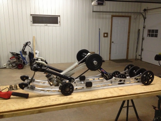

Ext kt was definatly a tight fit on the rails and stuff but once on is solid. Great job on the machining OFT.
Installed a 2" profile track. Very tight fit. For those of you out there wanting to go to a 2 1/4 " or bigger, cant say it cant be done with stock drivers but to me it doesnt look like it.

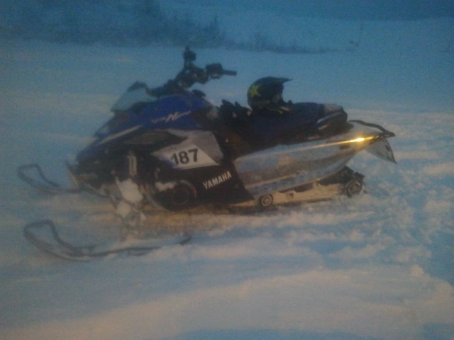

I think it's ok to highjack this post as I sold fxnytro1050 my OFT kit and he owes me one ! I'll take some gearing advise while it's on topic. I'm going for the 136" Ripsaw to the 144" Back Country. My sled worked really well and by that I mean out pulling any stock 2012 800 Cat or Etec. ( and seeing 110 MPH + in 1200 feet ) Only thing done is the SB clutching. I'm not much for racing but it sure is fun surprising all the motor mouths. My plan is to run current set up and then make changes if need be. I ride mostly off trail but do get caught up racing from time to time.
