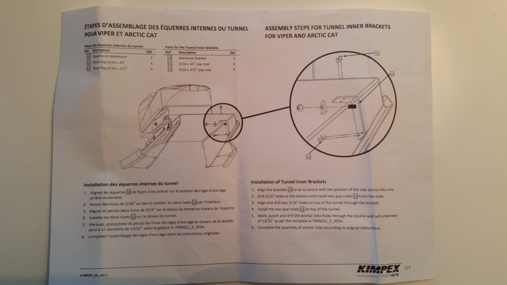

Thanks for the pics.
In my instruction it says that the rivets should also be mounted on top of the tunnel. Did you mounted the rivets on top of the tunnel? Se my instruction from Kimpex

Yes I just dont have any photos showing that. I used black rivets in the top since the tunnel is black.View attachment 148838

How did you manage to do that when the radiator is in the way?Yes I just dont have any photos showing that. I used black rivets in the top since the tunnel is black.

I think if you get under the tunnel and test fit the piece in place you will find that the length of the top horizontal portion of that bracket is not interfered by the tunnel heat exchangers.
Errr
It fits. It did on my sled. I suspect it will on yours.
Errr
