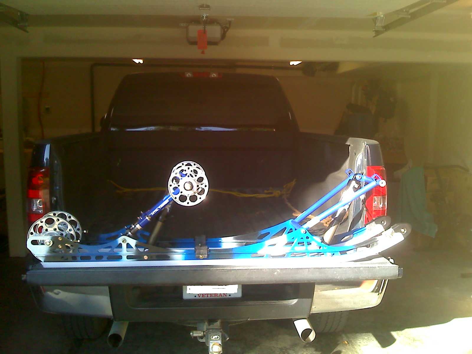

I'm running two 8" Avid rear wheels with an IceAge axle. I went with the Avid wheels since they offer a larger sealed bearing than most other billet wheels. I had to modify the axle a little to accommodate the wheels but they work great. The larger wheels allow you to run your track much looser when combined when Avid drivers too. There is a noticeable handling benefit to the two-wheel rear end as well.
