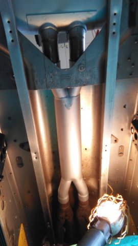

Plug both tail pipes, if it doesn't stall in 3-4 seconds then your donuts are gone or y-pipe under seat is broke, if donuts are original they're gone anyways.
If y- pipe is broke here's a great fix for that, and upgrade.

If y- pipe is broke here's a great fix for that, and upgrade.View attachment 111715
Who makes that?

Schmidt bros motorsports.
Its a 2.5" oval like apex.
The one in pic is the pro-type.
Sweet install, no clamps or gaskets.
To bad he wont be an advertiser on the site. He sure makes some good products.

Yes Chris Schmidt does, he is one SHARP Dude, talked with him many times about everything from clutching to exhaust and every time I am amazed at how he can prove what he says.
