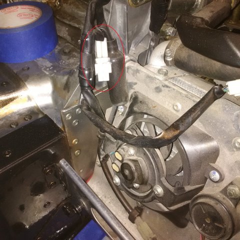

I picked up a used Ohlins rear shock to install in my 06 RTX. The issue I am having is there does not seem to be a white connector to plug the sub-harness into on the sled. It was my belief that all Apex's had the ability to plug and play the Ohlins shock as an upgrade.
See pics for missing connector.. Any thoughts on a work around?

I installed the rear Ohlins on the weekend, I looked one last time for the sled side connector before putting all the plastics back on. My work around for this season is to tape up the connector and zip tie the lead out of the way on the shock. With any luck I will figure out how to get this shock working soon.

Did you acquire the sub-lead that runs from the connector under the hood to the connector on the shock itself? I've yet to see a 06-10 Apex without the connector coming out of the right side of the sled's body harness...

Did the same with my 06 RTX.....the cable was there, it had a white protective plug that had to be removed in order to plug in your shock cable

If you have to remove the gas tank its buried in there near where you took the picture.

Could be bundled in the harness with the rubber boot over it adjacent to the cooling fan, peel it back and have a look.

Yes, I have the sub lead harness. My VIN ends in 1505 so it wasn't the first sled built, therefore it should have the shock connector. I will check again for the sled side connector to see if it is tucked up between the tank and the chassis.

Fairly sure it is closer to the area above the chaincase rather than the oil tank if that is what you were referring to.

I found the sub lead very quickly on an 07 RTX
