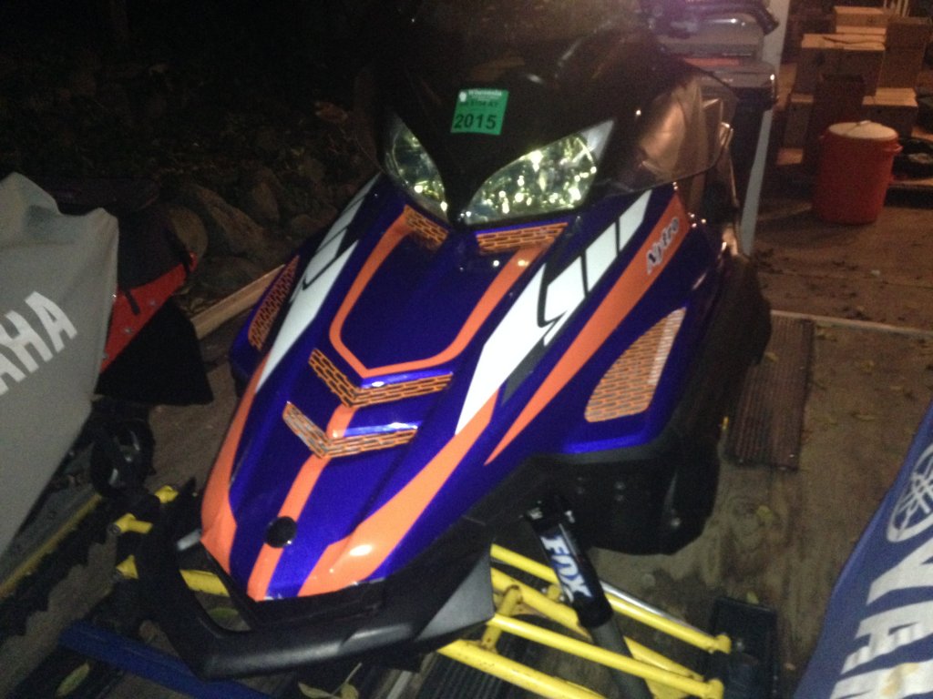

First off... that's a great looking sled! I got mine about a year ago and I put almost 500 miles on it, which doesn't seem like a lot to most people, but we normally average 150 miles a year! When i got mine, we changed the oil, put new spark plugs in, and some fresh gas, and never looked back. heres a couple of pics of mine with a special "LE" paint wrap so it looks like how they had the new vipers a couple years agoI ended up getting a 2006 Yamaha nytro with 2,300 miles that's the good news.(those that will ask it was a mile a buck so not bad) the bad news is she needs some re-freshing and I'm concerned about one major issue.
My list to due..
New hyfax
4th wheel/big wheel kit
New rear shock
New HID head lights
Oil change and general maintenance
Get a pump for fox shocks..
And if that was not enough when I was un-loading her the windshield caught the top of my trailer and really messed up the plastic around the gauges and pulled it out it's resting position and may have trashed the windshield
What I'm really concerned with is the way the skis sit.. one sits straight as an arrow and the other is well not straight. I'm looking for advice on all ends of the fix
I'm not a rich man by any means so some of these fixes will take awhile but all should be done by end of sept early oct... is it snowing yet?!?!

Oh man killer looking nytro!! My PayPal is all messed up or I would have sent my last payment to Travis at barn of parts.. all those items are on the list!! I may have had a couple to many adult beverages and starterd her last night. No choke fired up with in two seconds!View attachment 130023 View attachment 130021
