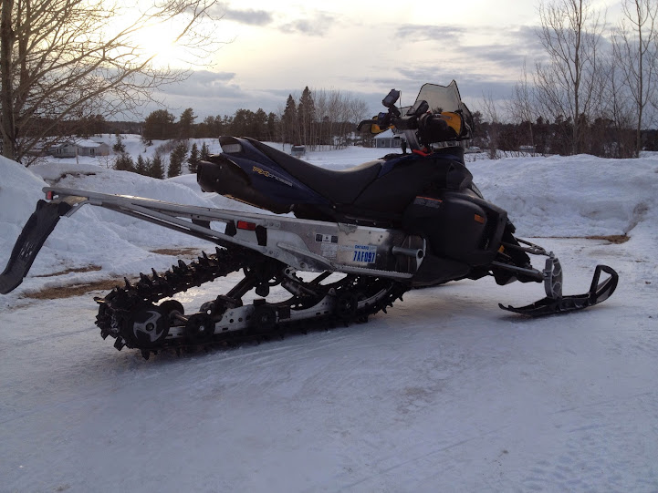

So dosent look too hard to extend the track, and did it come with those larger rear bogie wheels? and didnt lok too hard to extend the tunnel out

If you are talking about my skid, the black spoked rear wheels are Yamaha accessory wheels. These are the stock diameter and have replaceable bearings. A great wheel for the money. I did add (1) additional wheel per side right in front of the original rear wheel adjuster and the extensions. (See Avatar Pic) If you use a stock Phazer Mountain or MTX rear bumper, it would be easy to extend the tunnel. I used a Yamaha MTX GYTR accessory rear bumper which is aluminum and was not strong enough with just an aluminum panel closing out the top of the tunnel. I had to make aluminum reinforcement side plates for the GYTR bumper to make it survive. I cracked my first one which was blue. But a stock steel tubular MTX rear bumper should be strong enough to close out the tunnel on top and is a bolt-on for your sled. G.B.

Okay, so you moved the stock wheels to the back of the track and put them on both left and right sides? I want to do the exact extension and job you did in your thread it looks very good, and it seemed to me with like $800 bucks It can happen.

Here is a pic of my S/C Phazer with Nytro skid and 153 track. Nytro stuff is cheap, buy track and skid and alter. Cut down track on table saw, narrow Nytro skid and install! You wouldn't believe where a Phazer will go with a 153 2.25 lug track.

Wow beauty extension! I'm trying to do that this summer!
