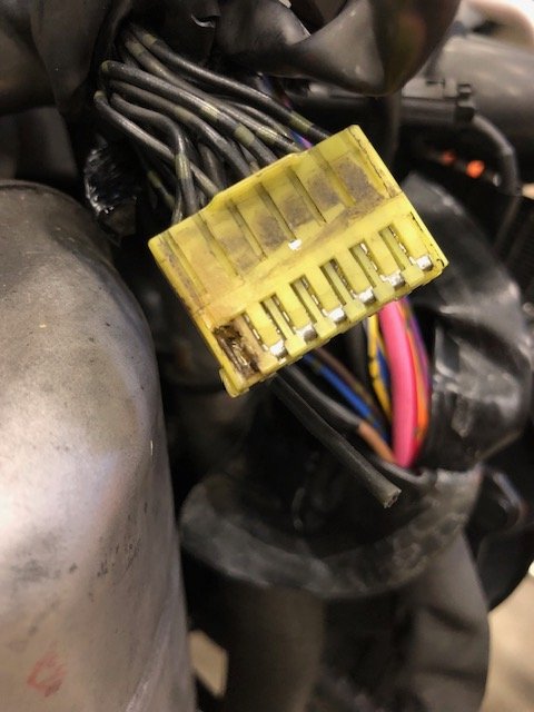

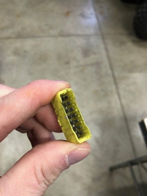

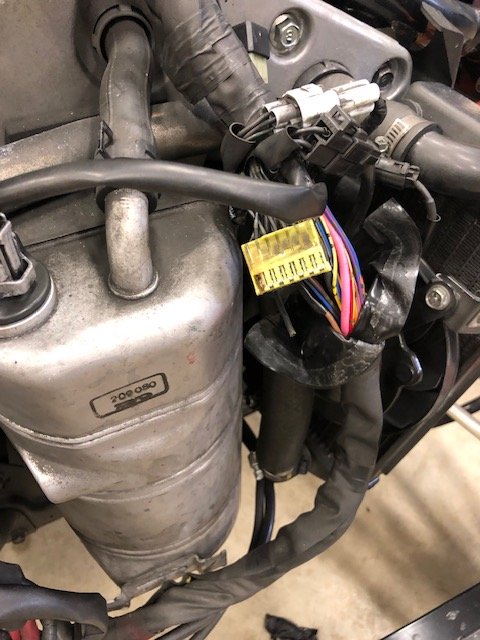

Solved the issue. It was a ground issue in the grounding block near the fan. The ground wire coming into this plug had been arcing and had a lot of carbon build up. The plastic from the plug housing had even melted to the terminal.
