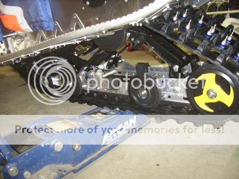

Could you let us know what sort of reinforcements/mods you made to the rear skid and how the skid held up through the race?
There has been lots of talk about the front end race prep, but Yamaha tends to build relatively weak rear skids and unless the Nytro is an exception, I can't see a stock skid holding up for an entire race like this.
Rex look back at my pics of the rear skid in the forth post in this thread.
You will notice rail reinforcements between the second and third idlers under the rail bumpers and the front torque arm is reinforced in a couple of places. There also is a solid steel rear axle installed. The stock transfer blocks are off many mid to late 90's early 2000's Polaris Xtra, edge rear skids.
