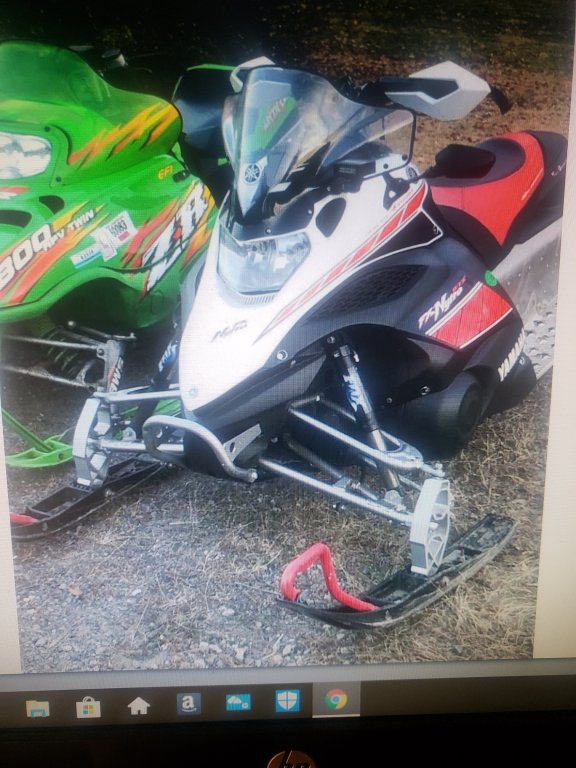

hey guys it has 2500 miles it has a can guy wants 3000
you think its worth it going to look at it tomorrow
dont no the problems nytros may have whats your opinion

Miles? Those mirrors are worthless, that's top of the market I'd pay

The subframe is bent. The left shock should be close to centered in the upper a-arm.
good eye grizz-- plus all the changes from the 08 to 09 means you have to get an 09 or newer-

Even if the frame is bent it only has 2500 miles so it's still worth around $3000. The frame can be replaced or in some cases straightened and reinforced so it doesn't happen again. You might be able to talk the owner down a little on price due to the frame issue. I prefer the 2008 front geometry over the updated 09+ sleds so don't let that scare you away.

If its clean, I would say that's a good buy. Miles are miles. I bought an 08' Anniversary Nytro two years ago for $3,000 with 5,600 miles that was stretched to 144". My subframe was also tweaked and the steering pivot was loose and ovaled the mounting holes in the subframe brackets. I bought grizztracks subframe reinforcement kit and straightened the frame and welded in the reinforcements. Looking forward to getting it on the snow for the 1st time this year if we get any snow. I think the 40th Annivesary sled colors is one of Yamaha's best color combos. G.B.
