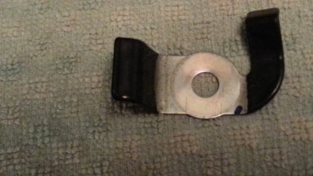

snow11

R00STER
- Mar 3, 2013
- 423
- 76
- 858
- Timmins, Ontario
- 2013 Nytro xtx 1.75
That is a wire guide that goes on the rear of the fuel tank. It holds the brake light wire over the back of the fuel tank.
snow11
- Feb 17, 2014
- 70
- 158
- Skowhegan Maine
- 2007 yamaha apex
Ok thanks but when I was taking the right side panel (if you're sitting on the sled) that's where it came from
