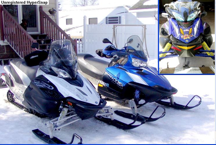

The '10 LXT is a great sled. Previous was Apex ER '06. Best performance is 0 to 80 mph. Not the long legs of the Apex after 80. My best speedo has been 102 on current snow conditions, Vs 125 on the Apex (114 GPS). Vector much quieter handles better, still darted. 21 mpg Vs 14 mpg, same type driving. Bergstrom triple point, shims and space savers really help. Darting gone, but still hunts (follows deeper ski paths). May try dullies (wash my mouth), Stud Boy Dueces. Also have Sly Dog with Bergstrom set up, no real difference, likely sell the Sly Dogs, need more test time. Sly Dog on the Apex ER were great. The blades on the Snow Trackers should help. These are similar to those SLP uses on there short carbide SLT's, which really worked on my '02 800 M-10 Polaris.. Still have those blades and may modify to adapt to the Bergstrom. Always something to do.
