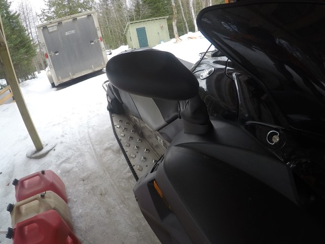

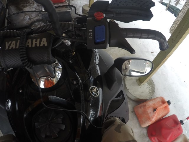

I have done this on 6 different Attaks,Vectors. 07 to 2016.. the only ones that will work are the Tall Indy Style mirrors found on Ebay.. about $ 45 or so. They are double pivot so they work. The oem yami's were only single pivot thus didn't work. The only issue with the Tall Indy's are the plastic they use. You have to be careful in real cold not to wack them in the trailer. They fold nicely away so that solves that. But in real fidget temps one has to be careful folding them away.. with that you'll have good luck with them..
They never get caught and don't stick out past the skis at all. And can be adjusted to fit the size of the rider.. Wife is 5'6" and I'm 6'2" have them on her past 2010 Vector LTX for 10000 miles.. and now the 2013..
I found they worked one day while looking at a used Apex that had them. Shear luck.. I don't like the handle bar types at all. I was amazed these worked..as I had bought the OEM yami's for near $200 and they didn't do a thing... Double pivot vs single pivot ..big difference.
Hope this picture helps I'll try to dig a better one up if you don't like it.

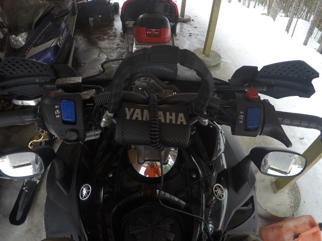

I have the one that attach to the aluminum frame of the hand guards and work well. Not directly to the bars.
