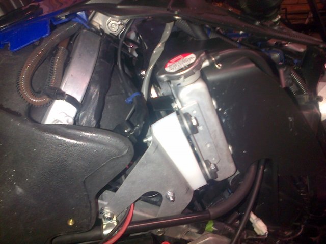

nytro rocket..... are you running a trail tank? I had some issues with my nytro temp light / cooling issues, which all seemed to be from snow/ice bridging on the front heat exchanger, and it would take a surprisingly short time for this to occur. I made the following mods and have not had any issues since. to start I had made the following change prior to having issues...... I added a rail tank, which drastically reduced the space behind the radiator (and sparkplugs also.....but wouldn't go back to stock). Over the following summer I added an OFT steering relocator, Mountaintech vented dash, I then made some rad relocation spacers to push it ahead creating some more space between rad and gas tank. the relocator is necessary to complete this but, not the vented dash but, it does help a lot I m sure. I guess it would have been better to test one part install at a time to determine the value of each part itself instead of the result of the sum of all the parts as a whole...... sorry too busy/lazy for this . I sent a set of blocks to "dhskir" to try out a set, maybe he ca n also chime in and add some results if any??? I attached a couple pics of spacers I made and what they look like installed. note: both the steering reloactor and vented dash parts are high quality parts.
